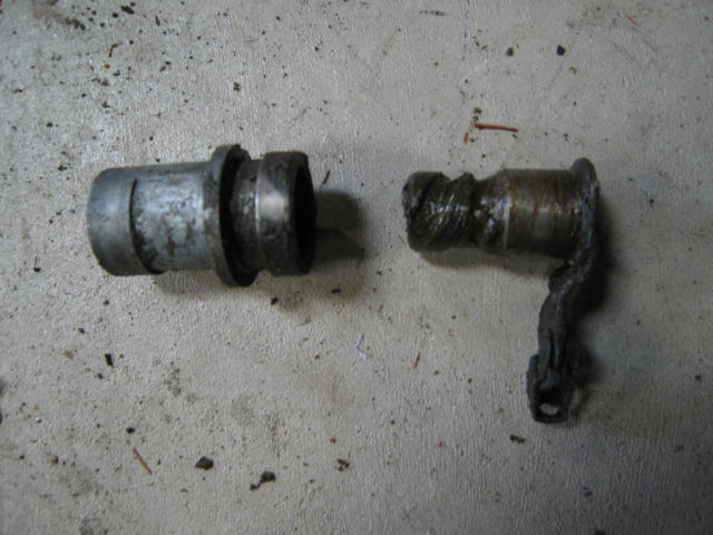

Does anyone (by chance) have a picture that they can post of this 'fixing piece' behind the motor casing that I can see... ?

cyclon36
Posts: 528
Location: Temple, GA
Post by cyclon36 » Tue Dec 07, 2010 12:47 pm
Here's a pic. The one on the left is the adjuster that you see from the outside. The part on the right is the inner part. When the adjustment screw gets turned, it moves that part in and out of the adjuster. The latch on the bottom of that piece that you see is what the clutch cable gets attached to.

Okay, now we are getting somewhere...
So, I understand that the latch on the bottom of the part on the right is where the cable is attached to... Mines connected now.
I see the part on the left is the big 'bolt' that i have to turn to the right.
Now, once I turn the big bolt to the right, and i put the 6x40mm screw in, where does it connect to on the piece on the right in your picture? is there a hole it goes into on that part?

Post by cyclon36 » Tue Dec 07, 2010 2:12 pm
There is a hole in the adjuster piece with spines inside. The piece on the right gets inserted into this and is pushed in and out by the splines force against the spiral cutout.

Post by Sascha » Tue Dec 07, 2010 2:27 pm
BINGO... thats what I needed to know...
So when I put the bolt in, it will thread into the adjuster piece (the piece that is big and grey that I can see from on the engine casing). In short, the adjuster is the 'end nut' as the bolt threads into it, so I dont need to open it, i just need to put a bolt in... Im going to give it a run tonight and I will let you guys know how it goes.
