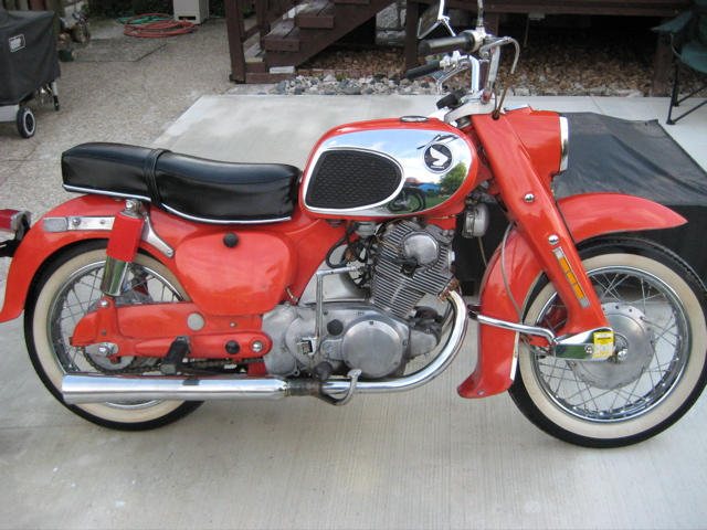

Hey, all. I've been reading a lot of posts quietly in the background. Really learning a lot. So, thank you. I've got a '66 Dream. Been riding hard for several weeks. About two weeks ago, I started up, turned the key to head/running lights position and blew a fuse. No worries (I think). This morning, after riding for about 10 minutes, I parked the bike. I decided to change parking spaces and as soon as I hit the electric IG, I blew another fuse. Got the battery on a trickle charger now. Acid levels seem good (maybe a little low). Just wondering where to start tracing this down. Rectifier? Loose wire somewhere?
Any help would be welcome. I kind of a noob when it comes to the tech side, so be gentle. Schematics are the equivalent of Latin to me. And I took Spanish. Really appreciate it. Thanks.
Also, if someone could tell me the type/year of my aftermarket mufflers, I'd be grateful. Thanks.
marc

Is the battery new?I would start by doing a complete visual check of your wiring for any rub points going thru the frame or in the HD light bucket or anywhere else you could think of.Check all of your connections as well.Kind of hard to find intermittent shorts like that.Also, I think your bike is a 64' and not a 66' looking at the right engine side cover where the clutch cable comes in unless someone changed it.That was changed to a shorter cable that came down strait into the cover instead of on an angle thru the side cover.VIN # would ID the year.
