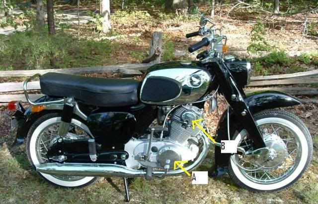

Just making sure:
I need to take off both A and B to do the timing with the points, correct? The little book says "right side crank case cover" and I'm guessing that's what A is.
Also does anyone know the bolt sizes that hold plate A on? Mine have been stripped like crazy and I may have to drill them out :(
Thanks!
btw this is not my bike, just a picture from the internets

Post by joeweir1 » Thu Jul 01, 2010 2:42 pm
Your correct on what covers to take off.

Post by paperslammer » Thu Jul 01, 2010 3:40 pm
Ah I think I found the screws on this site
It is part number 9370005016
(93700-050-160A) SCREW CROSS 5X16
Note: this part is superseded by 93700050160A.
How can I tell if this part is JIS or metric?
Thanks!

Post by paperslammer » Thu Jul 01, 2010 5:35 pm
Resolution:
They are JIS thread.
I am getting them from Fast Fred (on this forum) his e-mail is FASTFREDKOREN@aol.com
Hooray progress!
