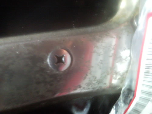

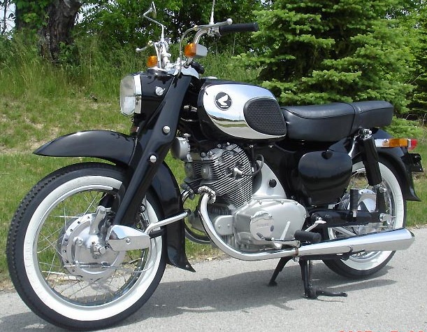

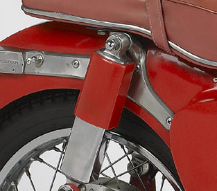

I've attached a pic of the polished one. I don't know the history on the bike, but there's nothing else on it that's polished that is normally unpolished.. so it would be kind of odd for someone to take just these two parts off and polish them up professionally. I've also found a couple of other CA77s that are in collections/museums (see the pic of the red bike) that show these parts polished. That leads me to believe at least some came from the factory this way.
the '64 is the one I'm more concerned about. I've cast a lot of aluminum and know that these parts have never been polished. So do they get a clear coat over unpolished, or do they get painted with the silver paint that matches the engine? They had what looked like rattle can silver on them... so I don't have much to go on.

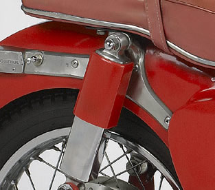

Engine casings, top & bottom, are bare -- not lacquered; as are the upper/rear shock mounts (fender supports), alternator & oil filter covers, points cover, Stanley taillight trim, winker housings, handlebar switch ass'ys, hubs & brakeplates and upper steering yoke (triple-tree).
Krylon Dull Aluminium-painted:
  • Carb covers
    Clutch cover (engine left side casing)
    Kickstart cover (engine right side cover)
    Starter motor & end covers (not the spec plate?)
    Horn (not the spec plate)
Internet image -- not mine (I wish....)
