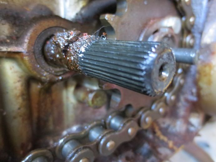

I have been having trouble when trying to shift into second gear. It gets stuck sometimes and I have to mess around with in while riding. Little dangerous. The neutral light has been finicky before so I wanted to take the right side casing off to see what was going on
Do these things look normal?
Shifter spline looks good I think
Anything abnormal here? Gear looks like it's in good condition too.

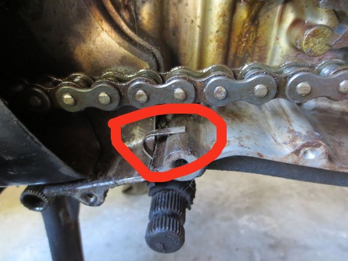

What is this piece doing?

Mine tends to loose it's mind once in a while but only on downshifts, never upshifts. From what I see all looks good there. I'd say either ur clutch is not FULLY dis-engaging causing difficulties or your shift mechanism is not quite right internally.

Also anyone have any idea what that crazy tab piece is? It looks like it's not supposed to be there.

Don't know what the tab is. It's literally been 30 years since I had the cover off mine. Get online and look at a parts diagram, it might show.
