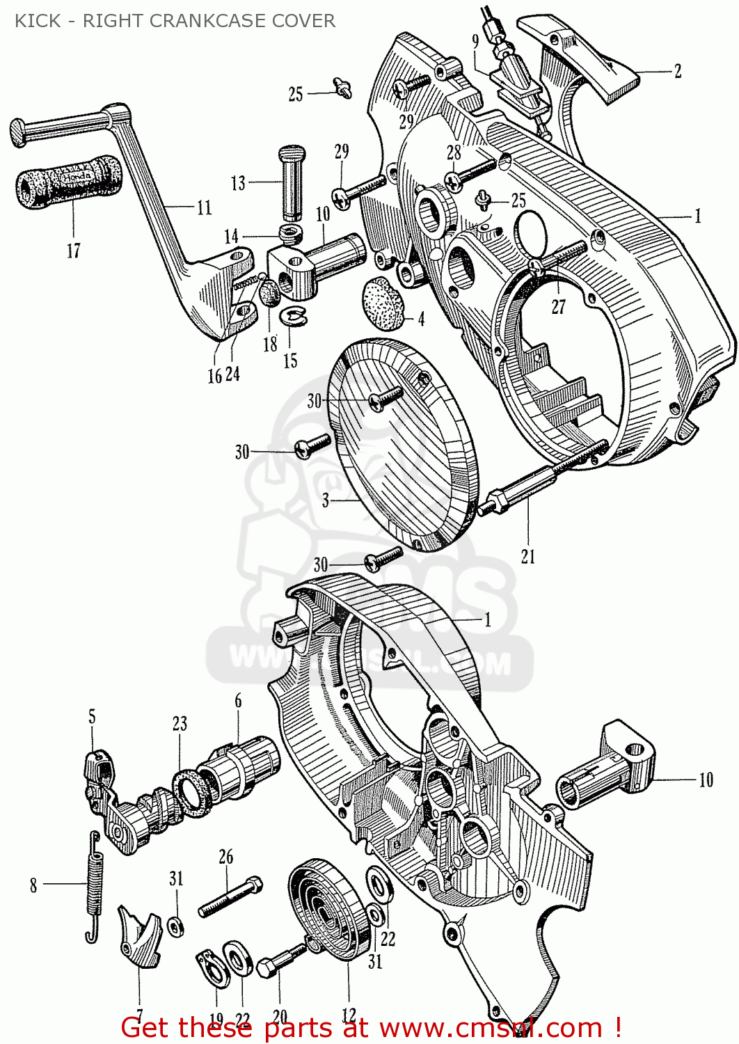

There are a couple of problems with the kickstarters on these bikes. The 'knuckle' on the bottom of the kickstart lever drives a splined shaft from the engine and is a 'loose' sliding fit. If the spline gives way you will get the symptoms you describe. You have to pull off the right hand engine cover to diagnose this. Usually it is the knuckle bit that cracks and gives way. Before pulling anything apart I would download a parts manual or workshop manual. The problem with the knuckle looks like ths. The crack starts from a sharp corner at the bottom of the slot. ![]() It can be repaired by grinding out the crack, welding and re-machining. ![]() ![]() You can try looking for replacements on eBay but they are usually quite expensive. The second problem is a lot harder to fix. The kickstart ratchet is inside the engine so requires you to strip the crankcase..... G '60 C77 '60 C72 '62 C72 Dream '63 CL72
'61 CB72 '64 CB77 '65 CB160 '66 Matchless 350 '67 CL77 '67 S90 '77 CB400F Re: Kickstarter completely loose, no resistanceSome diagrams to help you.....
https://images.cmsnl.com/img/partslists ... 8_4d5f.gif 19 is the kickstart shaft which connects to the knuckle 20, 21,22 are the kickstart ratchet parts. https://images.cmsnl.com/img/partslists ... 6_6809.gif G '60 C77 '60 C72 '62 C72 Dream '63 CL72
