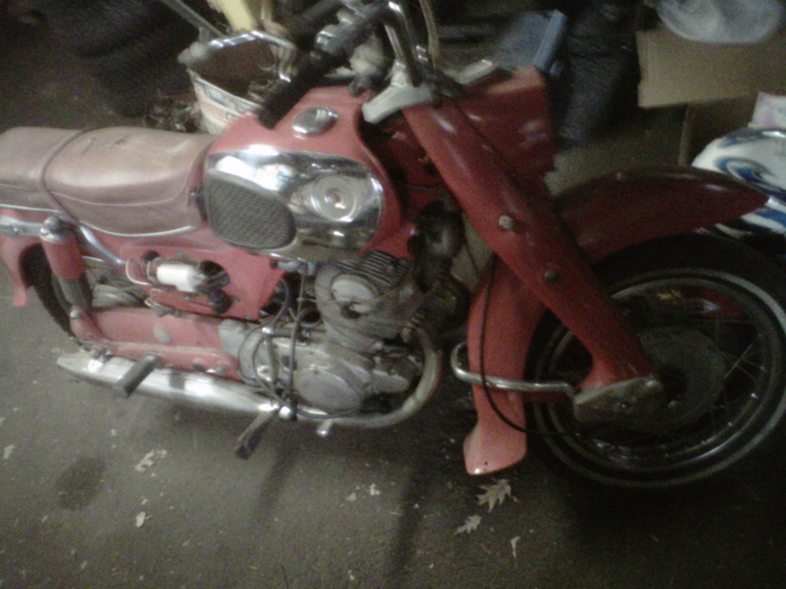

I recently picked a honda dream. From what I was told the carburetors were rebuilt. I know the bike sat for quite a while in a garage. I don't have an experience with motorcycles but I would like to get this bike in working order. I'm just not sure where to begin. I do have 2 manuals for the bike. I know that there is some wiring that needs to be put in order. I did pickup a new battery for the bike. What I was wondering is what should I start with? I was thinking if fixing the wring, hooking up the battery and seeing how it runs but I dont want cause damage to anything.
I believe the bike is 1966 CA77. I posted a pic of the bike as well.
Hi welcome. Some people here will be more willing to help you out if you update your location. So first off you should make sure it turns over well with the kick starter. Next make sure you have a good spark with new plugs (put the ignition leads on a new set of plugs and hold the plug to the engine somewhere and kick the engine over; battery required). Once a good spark is established pull the bowl off of the carb and make sure it looks clean in there. After that I'd say you're good to start it as long as the air filter looks clean and intact.

Jethro is right that the first thing you want to know is that the engine turns over. Try the kickstart. If it turns over you have the right order for tending to things. Troubles in your wiring can drive you nuts and keep your bike from starting. I agree with pknopp that changing the oil would be a good idea next. Jethro covered the remaining steps before starting.
You will really be well served by getting Bill Silver's Dream Restoration CD. It includes an owner's manual, parts manuals, shop manual, restoration guide and alot of historical info to boot. You will thank yourself. You will also find an enormous amount fo help from forum members. Go slow and be ready to ask any questions you have.
You key switch has 3 (or 4) red dots and 2 black dots. The black dot on the end is NOT off, though you can remove the key. It is for parking and the tail light will be on. The other black dot is off. The red dot on the end next to off will allow the starter to turn, but the bike will not fire. Before you start it up the first time, use this red dot to get oil up through the motor. Then turn the key through "off" to the red dot on the other side and that is "run" without lights.
