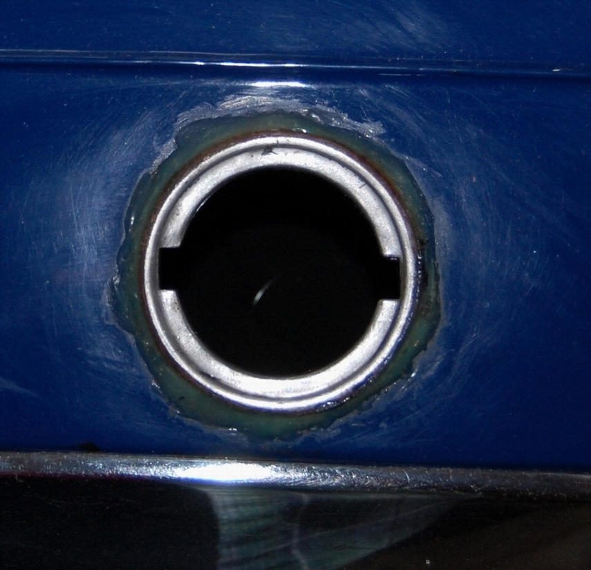

filler seal
When I was putting my bike together I was aware of this problem from forum posts. So I mixed up some epoxy and painted/globbed it around the filler neck, smoothing it with a finger dipped in rubbing alcohol. Looks funky but you can't see it with gas cap on. No problems after a few years and a few thousand miles. I always wipe off any spilled gas immediately after filling and leave a little space at top of tank (ie, don't fill all the way to top).
