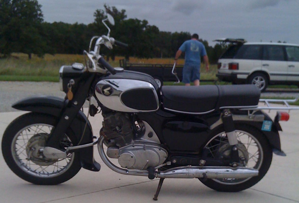

Post by quidger » Sun Sep 02, 2012 5:29 pm
Contact this guy about his after market petcock. I have had two Dream and put them on both after dong battle with the OEM petcocks.
Best decision that I ever made. Hard to see a good shot of it but maybe you an get an idea from the picture below.
