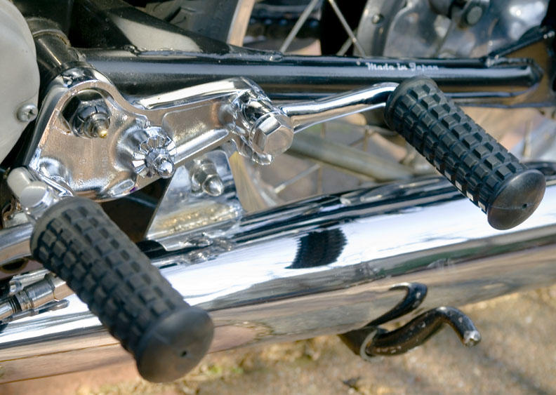

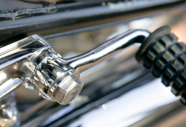

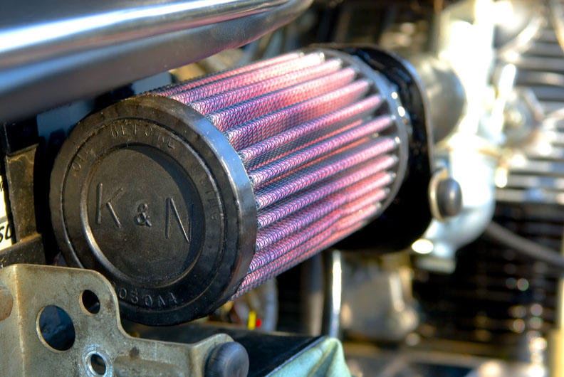

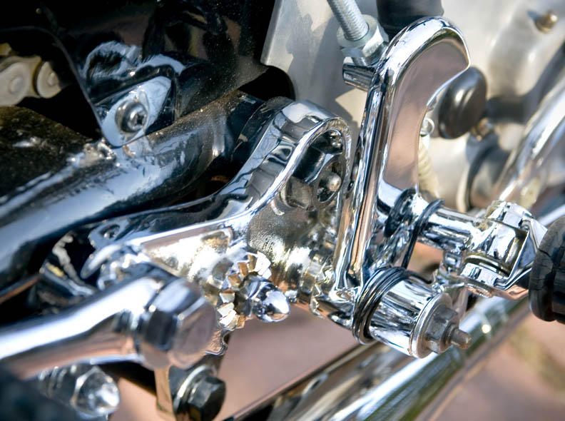

Well I picked up the bike today after its latest (and hopefully last!) round of mods. It was VERY chilly on the bike (about 40F) so I wasn't in the mood for a long ride, and it was getting dark (I know, I'm becoming such a wimp in my 40's). The K&N filters look awesome, and the chromed pegs/brackets -- well, what can I say...you'll have to judge for yourself when I post the photos. All the exhaust leaks are fixed, the 30 tooth sprocket is on, new K82 rear tire, blah blah blah. The only thing that may need to be done is to change the slides in the Amals from 3's to 2 1/2's, because the K&N's might now be causing the bike to run lean, but we'll have to see about that.
I'll post some photos of the latest when I have a chance!
Vince Lupo
Posts: 1371
Post by Vince Lupo » Thu Dec 20, 2007 1:00 pm

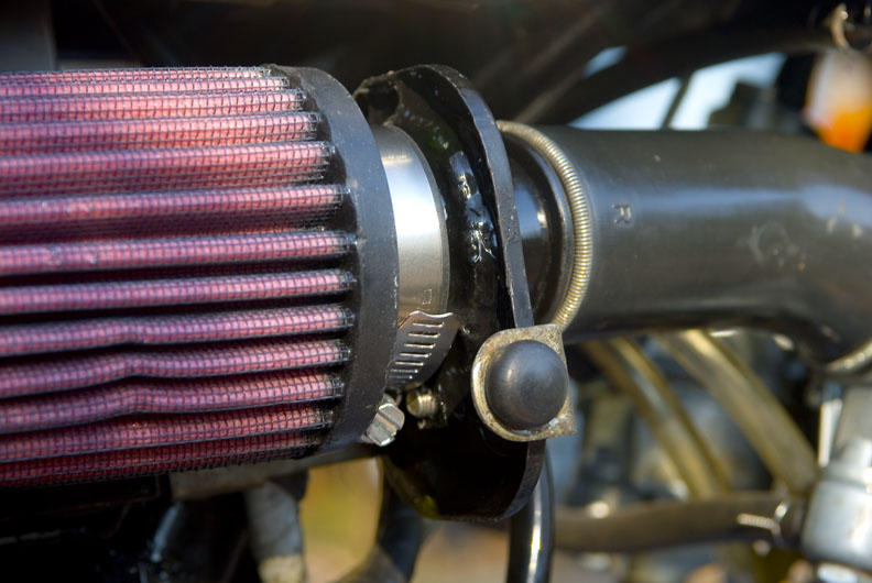

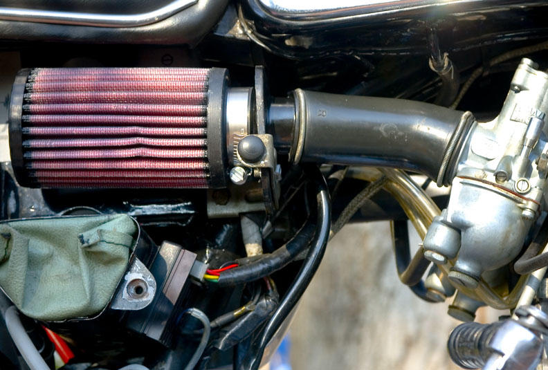

Well here are the final mods in all their shiny glory. The K&N filters utilise old metal filter frames from stock air filters, and the venting tubes simply attach to the spigots on the frames (they don't go into the filters themselves).

Here are the air filter shots. Can't say if there's a power increase because I've only ridden it a short distance from the shop to home....I'll let you know how it is when I put more miles on it.

As a follow up to the air filter mods, There is some debate as to whether it's a good idea not to have those vent tubes going into a filter, so that aspect may end up changing....stay tuned for all the drama!
Update: Just going to add a couple of small crankcase vent filters to the tubes and should be fine.
