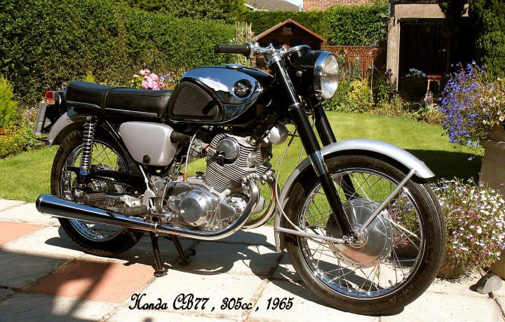

I have attached , I hope, a photo of my CB77 that I restored a few years ago
All the very best, Neale
