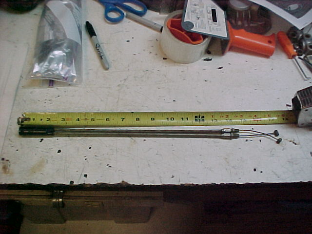

Making cables is pretty simple. Venhill makes cable kits that include the housing, end ferrules and various types of ends for the cables. I've made my own by cutting stock cables and shortening them. They need to be very clean or the solder will not wet the steel. You can also machine your own customer cable ends and ferrules on a lathe if you have access to one. I made my own ferrules because the stock ones were pitiful.
I would just use the stock cable splitter. I assume the CB has the same splitter that is used on the CL bikes. They use splitters on vintage Brit bikes too, so easy to find.

Thanks for the heads up on the cables. It looks like I just need the two short cables after the splitter changed. They need to be maybe an inch longer each and have the barrel-type fittings installed. Not too bad, I guess.
