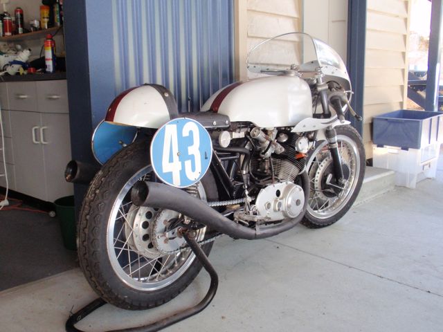

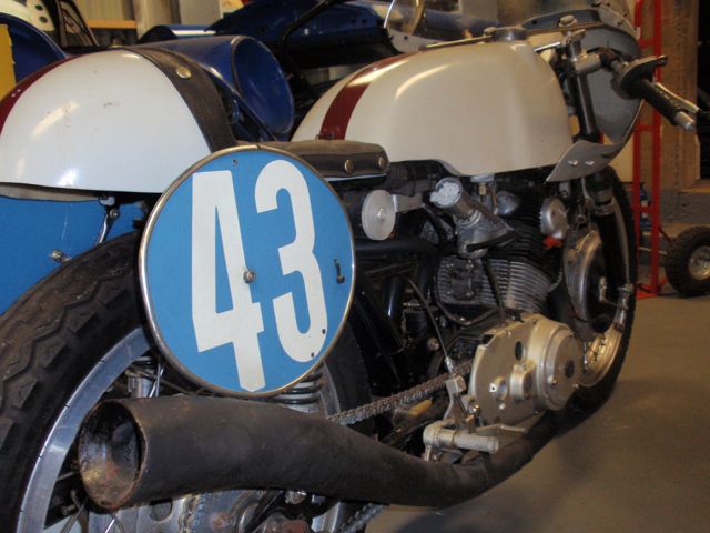

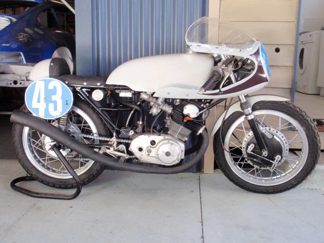

Hi All
First time post, and looks like I've come to the right place :)
I recently inherited my late uncle's cb77 race bike which has been in storage for nearly 20 years. It had moderate racing success in local classes, but I don't think it's history is significant.
I won't race it, but I would like to use it for the odd track day and perhaps get it street legal.
I'm seeking opinion on what I have, specifically important aspects to retain and any "tasty" bits to pay attention to (service/protect).
Here's what I know:
CB72 frame
CB77 engine (possibly kitted to 350cc)

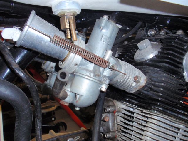

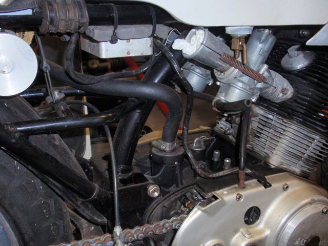

Amal carbies with custom bells and intake runners
Alloy wheels
Beaumeister clip-ons

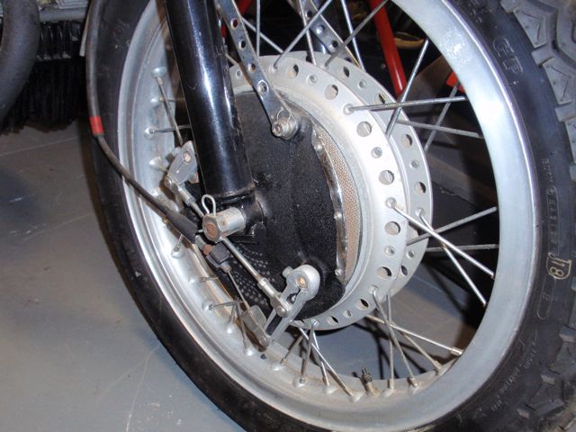

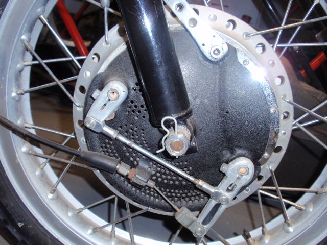

Interesting front brake drum - can anyone tell me what it is?
Alloy and glass fuel tanks
No kick or electric start

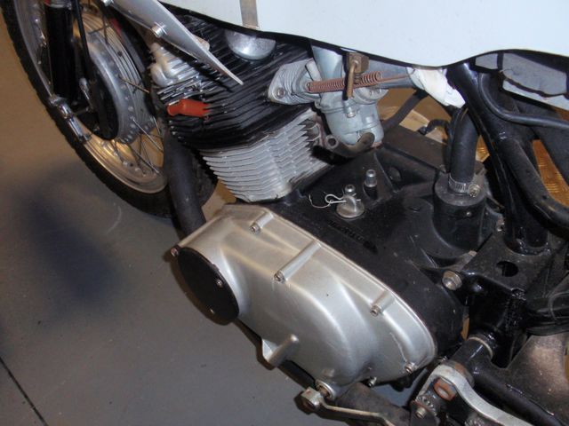

Ignition does not use a battery - some kind of total loss set up (capacitor?)
Please peruse photos and feel free to comment/critique what I have. I am not familiar with these bikes, but am looking forward to enjoying it.

Nice catch.
Front brake is easy. It's a modified GT750J Suzuki with modified CB72 backing plates. There's a lot of work in that.

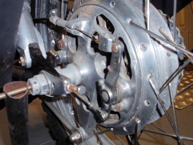

Rear brake is modified CB72. No surprises there but lots of work
Intake tubes/velocity stacks are worth keeping too. They were designed for 72 Beezumph racers (BSA and Triumph triples)
Motor is a 62 (?) with breather tower
Frame is nicely modified
Ignition on the right side hiding under that small cover is anyone's guess. I'd like to see what under there. The right cover is from a dream or CL

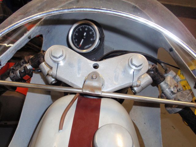

Forks are also interesting. They appear to be RD Yamaha legs in modified stock steel sliders with a custom top triple clamp.

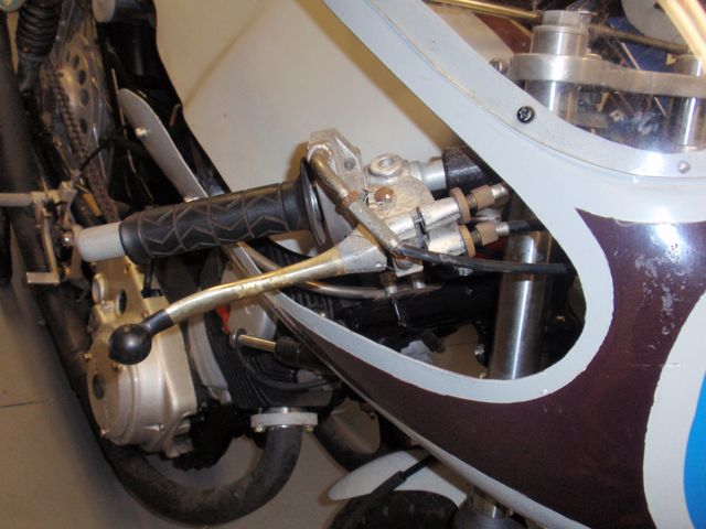

Nice quick action throttle, GP shift pattern (reversed lever), Kawasaki style steering damperr and modified race kit look foot levers.
All in all a nice piece of work.
Keep posting pics as you start to tear it down and inspect and document everything please.

Hi John
Front Brakes shoes: Use stock Suzuki GT750/550 or get them relined
Fork seal: Strip the forks and read the seal number or measure them. That's easy to do
Ignition: we'll know the answer to that after you pull the ignition/alternator cover off. It may all be more or less stock but with a thinner alternator.
There are a lot of unique parts and modifications on that bike. Will we see you at the Island next January racing it? Good time to start racing. You have teh bike. All you need are elathers helmet boots etc.
BTW, did anyone find the MA Logbook that goes with that bike? Your local MA office may have a copy on file if you tell them the story of the bike.
