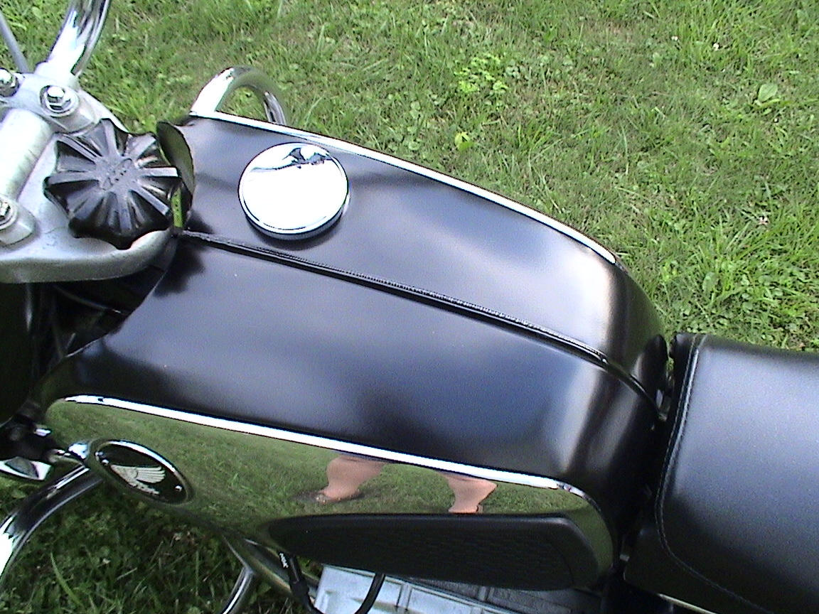

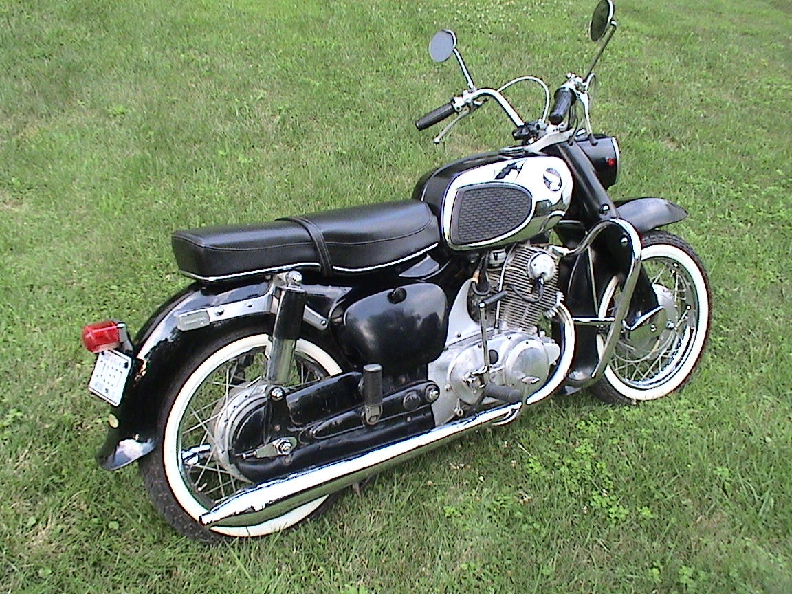

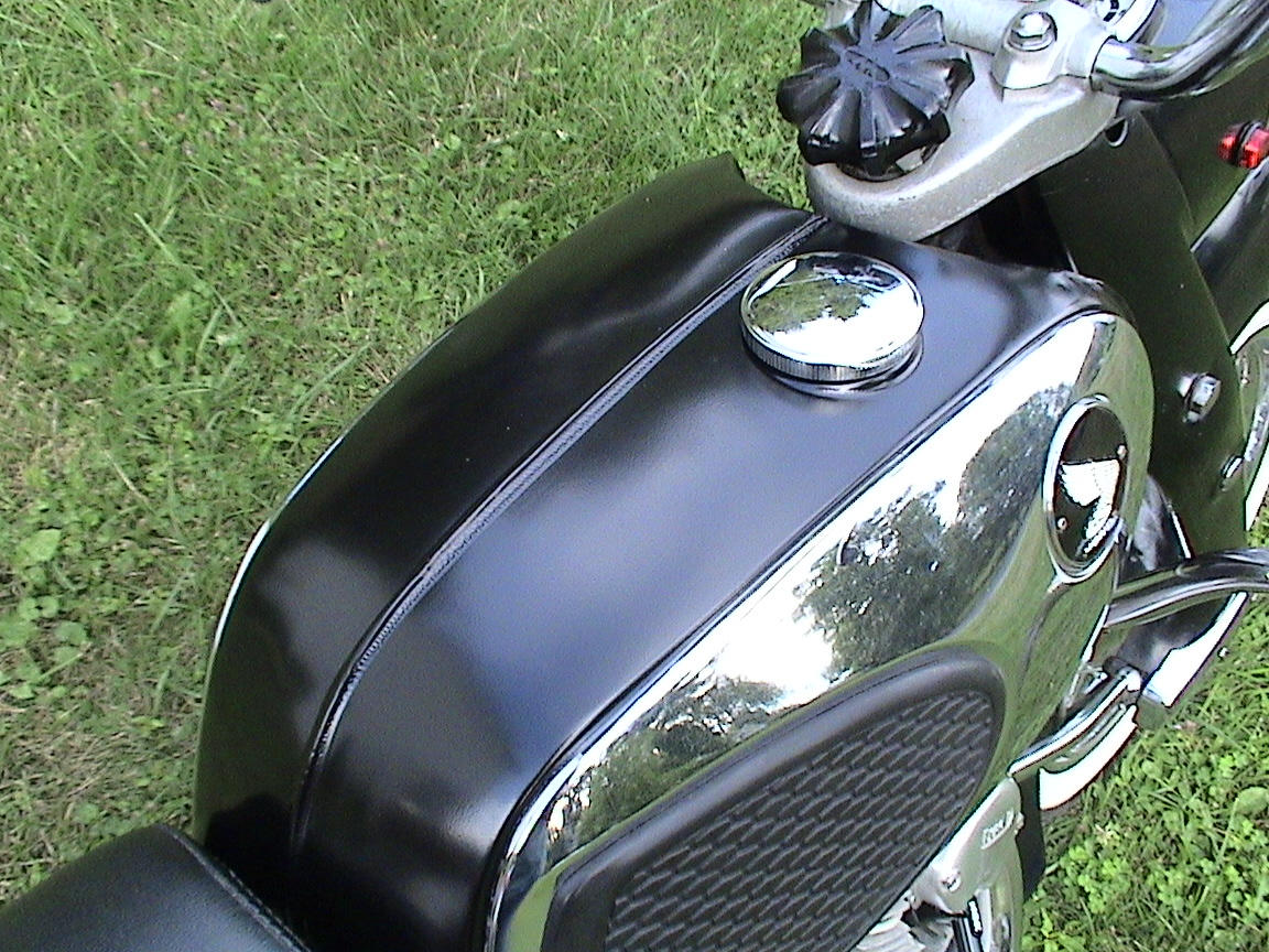

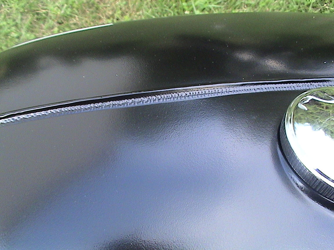

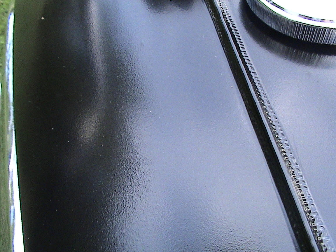

Just finished mine for now.
Not as good as I hoped, but what I expected for my skill and patience level.
Started with bare metal, cleaned with acetone, sanded with 600 wet, washed, shot 2 coats of Rustoleum Primer, and 4 coats of Rustoleum top (rattle cans) low humidity, outside, 85 degrees.
I noticed the spray fan from the nozzles applied heavy in the middle and lighter on the outsides.
Probably should have sanded between coats, but enamel takes forever to dry.
I waited about 45 minutes between coats.
Not bad from 10 feet, but the closer you get the more you notice the texture.
Think I should stick to undercoating or bedliners!
Pics attached.

Well, what the hell, so it ain't perfect. It is a very clean presentable machine that I assume runs well too, and that is what counts. I take it this is your rider and it is a nice one at that. I can only hope mine turns out as well. Ride safely, RW

brewski... you did a nice job on the dream! hey its good that you have the drive to get her done. keep at it and you will get that perfect paint job. heck it took me several attempts at painting various cars and bikes before i got the painting skills right. do you have before and after pics?
anything is possible if you have the drive blood sweat and tears to get it done!

You could try some polishing compound, that may put a shine on it. I just did a quick rattle can paint job on a CB500, the next day rubbed it with polishing coumpound, and you could see yourself in it.
The bike looks good!
Gunner

I thought about sanding and clearcoating, but after a week, the paint is still too soft to sand.
Just need to ride it for now.
I've done a few small parts with laquer before and they turned out better. This will be my last attempt with enamel.
I could tell from the beginning it wasn't going to be perfect from the irregular nozzle spray pattern.
