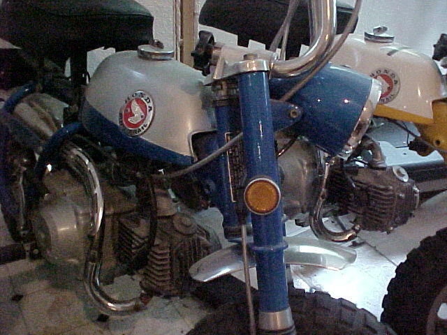

Post by davomoto » Wed Jun 03, 2009 2:32 pm
Rusty, here's one I've done on a Z50 before, and it came out really nice. base coat silver, I like the Rustoleum high heat silver. Top coat with testors translucent blue until you get the shade you're looking for. Here's a pic of my Z50 painted with this method.

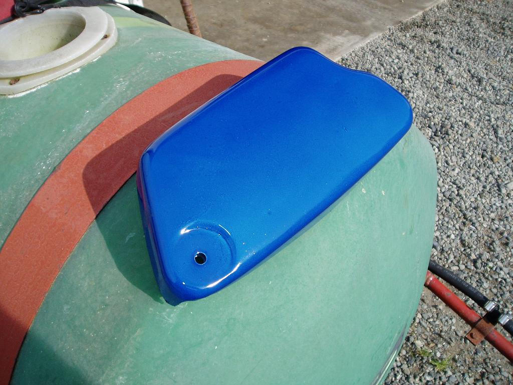

Post by rustywrench » Thu Jun 11, 2009 6:13 pm
Well I did it! The attached photo is done the way Davomoto recommended and this is the result. I used the high heat silver as a base and then the Testers transparent blue #1257 layered to this shade. It's not perfect but since it is not a museum piece it's OK. The Testers is a VERY thin paint and a bear to work with but all in all well worth the effort if you can achieve the right results. I do believe I'll do the other side cover and then the tank if I can find one that is correct for this bike. The one I have is leaded in at the tank badges and I'd rather have one that is right.
UUUUUUUUUUUh --------OOOOOOOOOOOh Am I sounding like a purist? Hmmmmmmmmmmm,
Thank you Davo for your help.
RW
