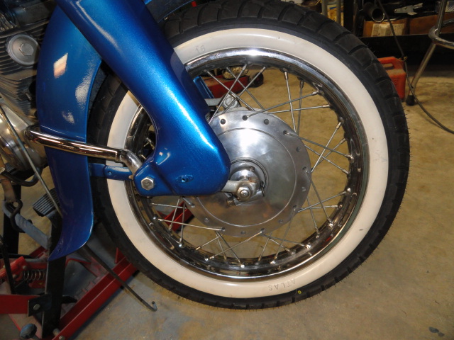

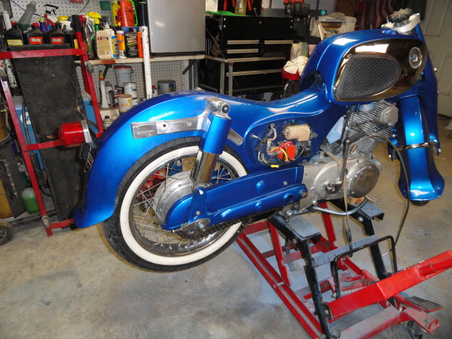

hopefully i can attach some pics now. dont shoot me for he color change on the bike. not going back totally stock, so picked an eye poppin blue. the wheels look great though. might have to adjust the whitewalls a bit. but its coming together nicely i think.

good to know. glad i wasnt home when he worked on those. lol but i will let him know how to fix the few spots that arent laying down. hes a harley man and he said the kendras look good, and have a high speed rating. not that i would even think about going 140. which i know the dream cant do.
