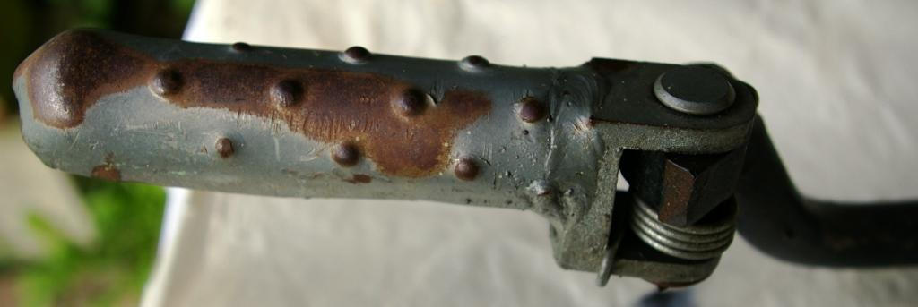

                    restoring old bolts

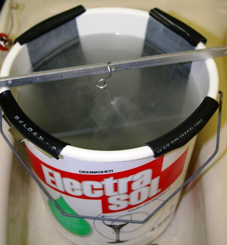

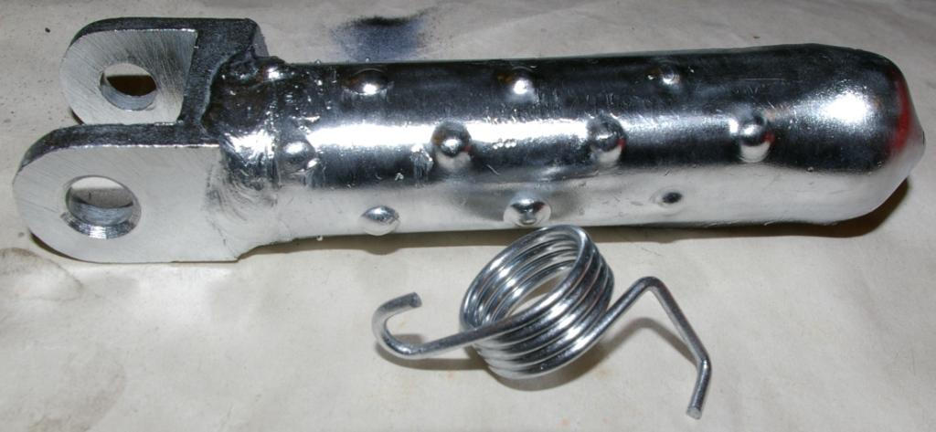

nc_rider--here's how I do it:
-wire brush and de-grease the part (I sometimes use electrolysis to remove major rust)
-hang the part from a copper or aluminum wire in the plating solution
-hook positive 3 volts to the zinc, and negative to the part being plated
-after 5 to 20 minutes, rinse off the part and brush it with a soft brass brush
Plating solution:
Dissolve 1/4 lb of Epsom salts and 1/4 lb of white sugar into a quart of white vinegar
You can see the bubbling as my coil bracket is being plated. The zinc is "Goodbye Moss Roof Strip" bought at my building supply store. I have also used zincs for boats, but I like the strip for its surface area and it's easy to fit it to the bucket. The tops of the zincs are held in place by copper wire around the lip of the bucket.

You're welcome, G-Man.
Standard safety precautions apply:
-electricity and water
-be careful not to create a short circuit
-the bubbles are hydrogen gas and oxygen
-don't use table salt--chlorine gas!
If you try plating with too much voltage or current, you will get a black, smutty result-brush it off and start again.
Sometimes I plate a part, rinse and brush it off, then re-plate. This adds layers of zinc and gives a better result than just one thick plating.
Wilf
