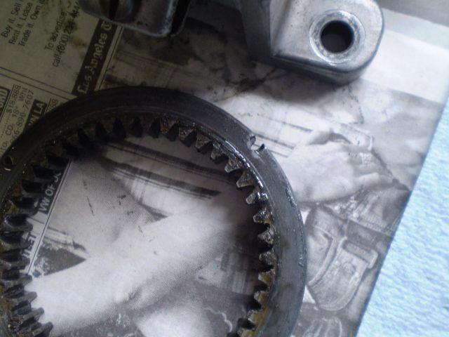

Spargett,
I had the same symptom. In my case, the pin locating the annular gear into the gear case of the starter had sheared. One picture shows the sheared pin at about 6 o'clock, and the other shows the annular gear with the hole for the pin at about 1:30. Are you still looking for the fix, or is your problem solved? Larry - Pasadena
