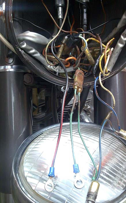

When the headlight was opened for the first time two cables came off loose. The green one is connected to the high beam lamp cable. The black & red is connected to the fork. Anybody knows were those 2 terminals should be attached?

Hi-beam mimic (indicator) lamp? Logical thought process takes me there.

But where should I attach it?
Those two are the only cables with this sort of connectors in the headlight case and all the other cables are well connected.
I don’t have a specific wiring diagram for this bike and I couldn’t find those cables in the diagrams of similar models.

Pleasure, mate. The ring terminals in your pic are (poorly fitted) after market. Is there not a red hi-beam mimic within your instrument cluster?

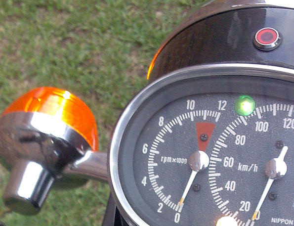

Post by bech » Mon Jan 04, 2010 5:45 am
There it is.
The green cable and the (also green) cable of the red hi-beam are connected. That’s why I don’t know where to connect those terminals.
I figured out the creative wiring fitting when I found the cables labelled with tape with Japanese characters.
Cluster
Cluster

Oooo, a green mimic; most are red. Probably a cluster from a 450BB used from the parts bin for this 'new model' back then?
Insulate the two wires and don't lose any sleep, Bech. leave them there 'just in case'!

A CB250 has another tacho / speedo unit. Probably these wires are for the illumination of one of the dials. Measure the voltage between them with light switched on and off.
