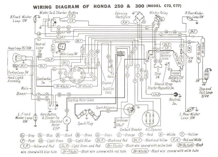

I am having a time finding a key for my NB ignition switch.
I have a "modern" replacement 4 wire switch from a CB500.
If you had to use this switch, how would you wire your CA77 into it?
The switch has a red (battery) lead, black (starter) lead, brown (taillight ?) lead and a brown/white stripe (headlight ?) lead and is a 3 click switch - off, dot, ignition
Is it possible to wire this into the CA harness, and what wires on the CA would attach to which of the CB500 switch?

Would like to know that answer also....before I could figure it out, would have to see the internal contact connection chart for the various key positions, something I haven't seen before, and not shown on any of the wiring diagrams.
I'm thinking you would have to have a separate light switch with a 4 wire switch, since the lighting position of the original also activates another coil in the magneto.
