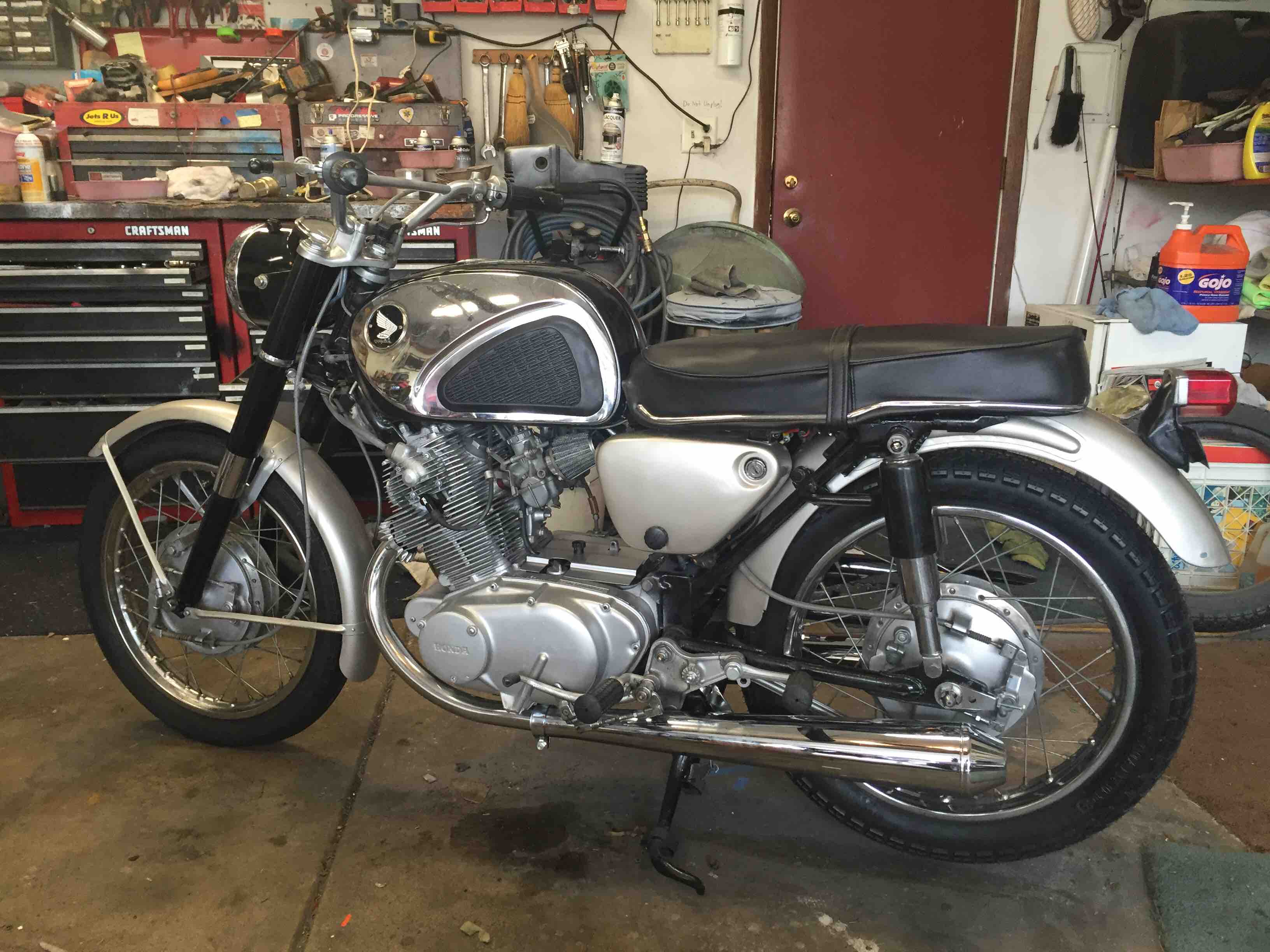

by the way ... here is pic of bike.. not a prize winner for sure but should have seen what i started with... my friends thought i was crazy for even attempting.. buy you know how us resto guys like a challenge... well forget that wont let me attach file for some reason.. but glad to share via eamil if anyone want to see.... woops guess it did post .. twice .. im a newbee...
