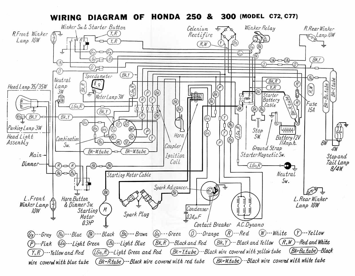

Hi. My 67 dream 305 Headlight, taillight, and speedometer have all lost power or stopped working. Can someone help me pinpoint the issue? Other than that, the bike is running really well. Any help is appreciated.

Check the 15A fuse in the battery compartment.
The other thing in common to those circuits is the ignition switch. Check the switch is working and that the connector in the headlight bucket doesn't have a wire loose or burned off.
If you don't have one, the attached wiring diagram will help.
