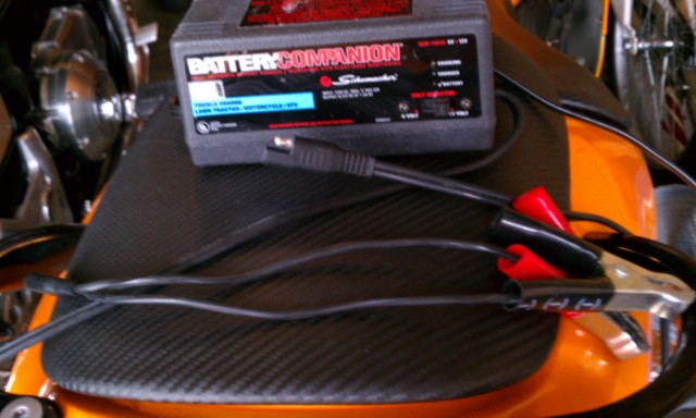

I use this Battery companian. It has a removable plug that can attach to the batt terminal clamps or can plug into a supplied plug that screws to your battery terminals that stays with the bike, it will just hang from the side of the seat. It will charge 6 or 12 volt batteries. I have one on my Ninja.
With this you have the charger available for other uses.
