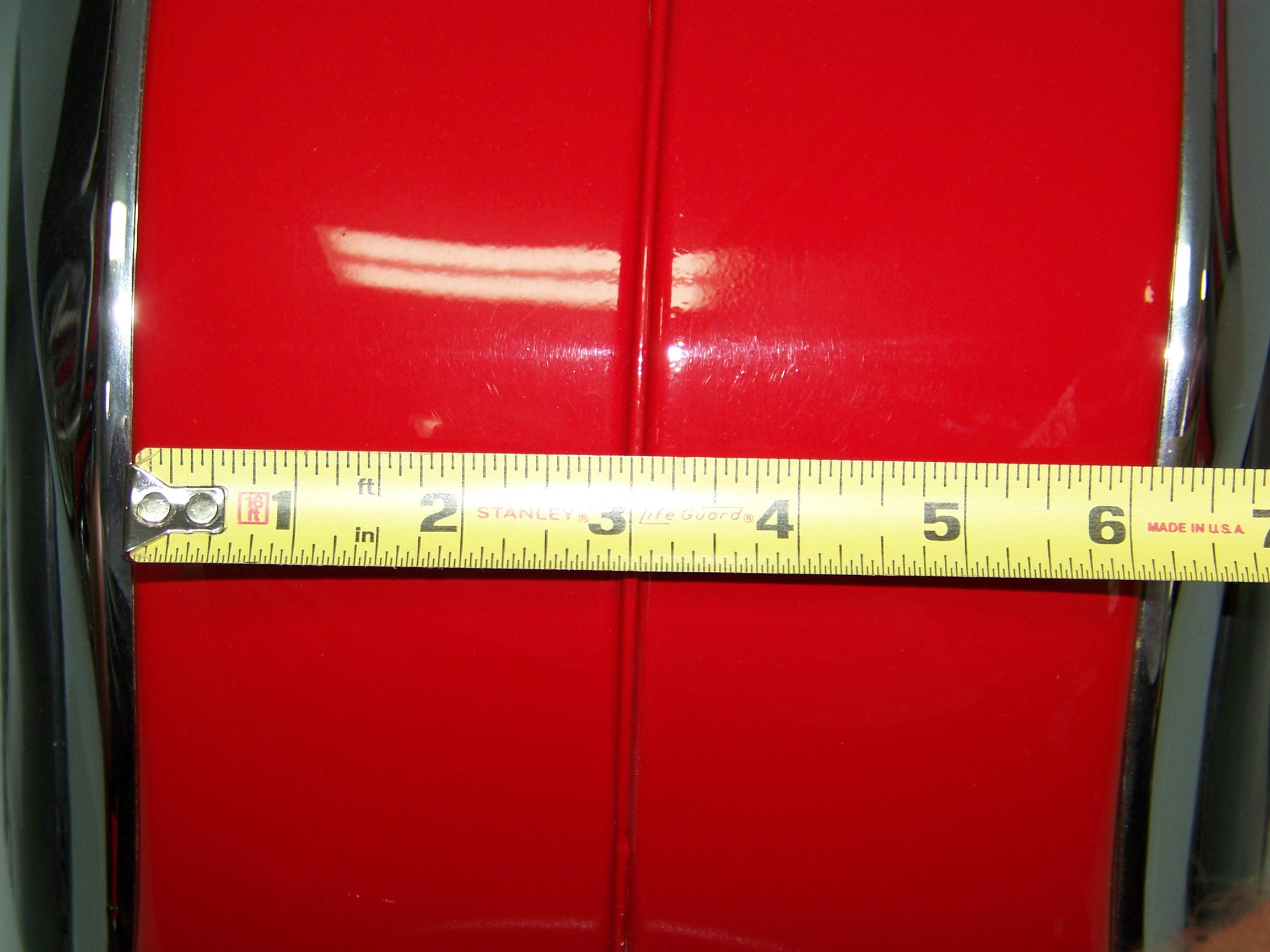

Post by slarsonroy » Mon Aug 16, 2010 7:54 pm
10mm spark plug has been confirmed. Heres a few more pics.
Inside bottom of headlight bucket.
I dont know where Buck measured the tank but here are a couple measurements.

Post by Buck » Mon Aug 16, 2010 9:28 pm
Here are the early and late tanks showing the different widths.
Post by LOUD MOUSE » Mon Aug 16, 2010 9:46 pm
Very interesting difference.
The wide one I saw was wider than the usual issue at the gas cap area. ...............lm

Post by Buck » Mon Aug 16, 2010 9:51 pm
I am having trouble downloading the picture of the kick arm. It says the file is too big. I have seen a couple of the wide tanks. I think Pat Jones 61 CB72 also has this wide tank.Look at the pictures of the kick on this bike that started this thread. It also appears to be the thin early one.

Post by jensen » Tue Aug 17, 2010 1:30 am
Hi,
Indeed Ed, it's difficult to see if the numbers are far apart or not when the numbers differing a digit, but I always take the last three or four digits, and compare them (the three or four least significant bits).
I didn't know that, good info Buck, never noticed the difference in with. I noticed that there where (at least) two types of gas tanks. The early one is shaped different then the later ones. Found that out when putting late panels on an early gas tank. They fit, but it doesn't "feel" right.
