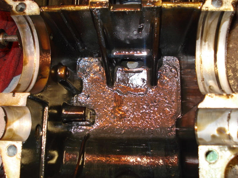

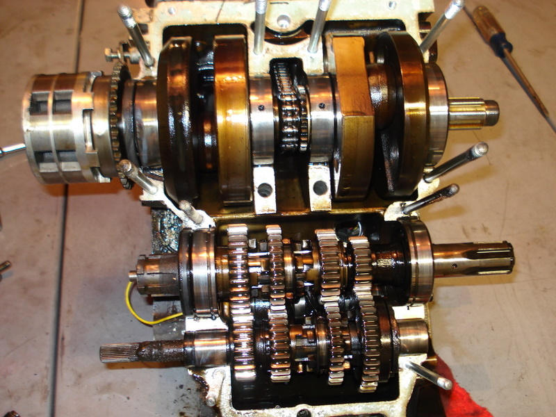

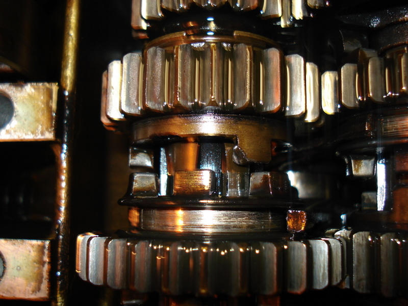

I finally have some pictures of the gearbox. I wish I had a better idea of what was going on here. My mechanic noted rounded off engagement dogs on 2nd gear and buildup in the sump. Is it clear what I'll need to replace? Does anyone have what I need parts-wise?

I'm definitely looking for second gear and the associated damaged one from the pictures above, along with a shift fork if anyone has one available. In lieu of the individual parts, let me know if someone has a complete gearbox in good condition they're willing to part with.
