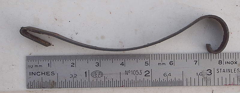

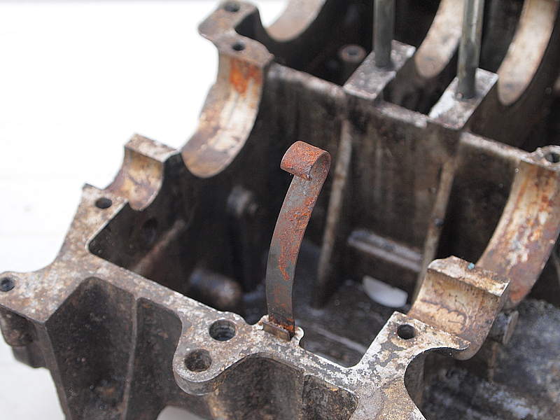

Managed to find the spring and how it fits in the case. Looks like the spring should be easy to copy. It appears to be 0.84mm thick spring steel and fits into a slot in the lower case.

Breather Spring
Graham, you are the best. Thanks so much for taking the time to get these pictures. It finally makes sense how the spring holds the breather body in place. And, if I can't find one, I could make one.
In the parts diagram, the little slot that the spring sits in is hidden behind two case studs and virtually impossible to see.
This was a great help and I truly appreciate it.

You're very welcome. When I first picked up this motor last year, I saw that spring but it didn't click what it was for. Your question prompted me to look and I have learned something too!
As one of my American friends says "every day is a school day"
Let me know if you don't have any luck finding one. I'm sure we could conjure something up.
