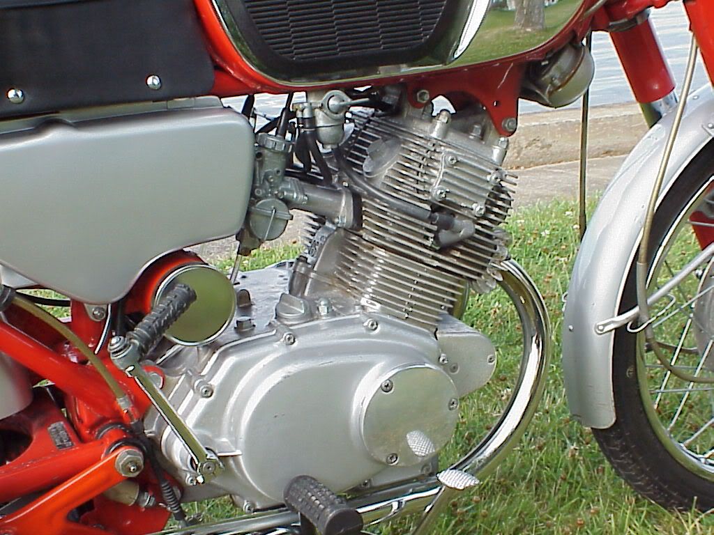

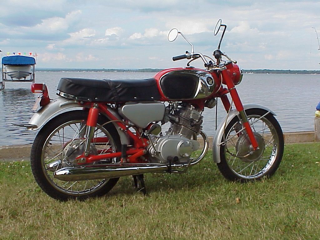

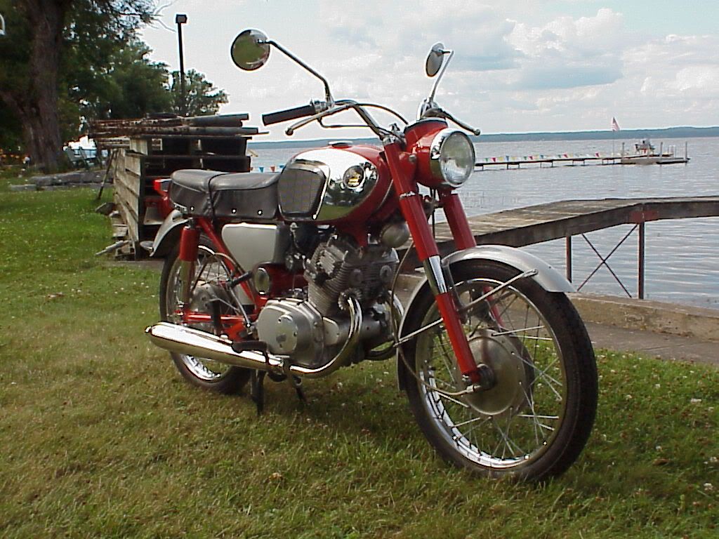

Side covers painted and installed. They truly finish off the bike.

Rob, that is a PRETTY bike! She's something to be proud of, for sure. Congratulations! Do enjoy her.
