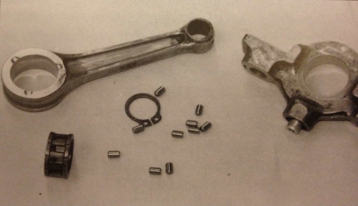

This pic is one of the three different sized rods for the Honda six and a main bearing. The rollers and cage look like they belong swith the main. Interesting slots in the cage to get the oil out.

Dear G Man, I believe those grooves are a Pops Yoshimura modification from when he "Consulted" for Honda. Apparently that relationship did not have a good outcome. Anyway I think you can see that if those cages were put in back to front the outcome is not so clever regarding getting rid of oil. I think I have explained to you that I used Honda CB360 flywheels and Honda CB250G model conrods and Capallini big end cages as used on the Honda CB450 crank assemblies for the 350 (67mm bore x 50.6mm stroke).We are allowed +1mm on the bore. I say again if you look up Jerry Kooistra on Facebook and look at the July 1 photos compilation you will find 2 photos of 500 CB77 crankshaft assembly (57.8mm stroke). Tag on the crank gives side clearances. Another photo shows late model CB77 conrod beside a Honda CB250G conrod. Just remember that the big ends are all the same on CB250G, CB360 and Honda CB450 5 speed. All the best Jerry

Yes - like putting a tractor tyre on backwards.

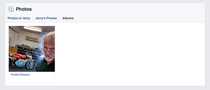

I cannot see any albums on the Jerry Kooistra page. All I get is this : your profile with just one picture of a handsome looking bloke with an interesting Honda behind him....
Apologies for being a facebook dunce...... :-)
