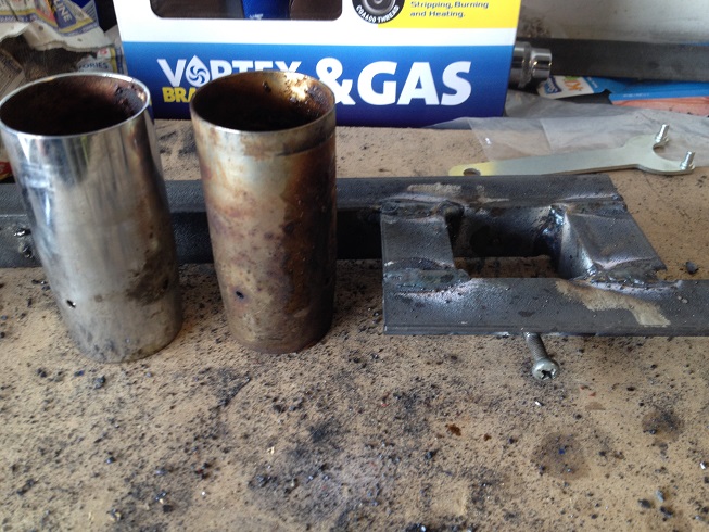

Post by eddiebpool » Fri Apr 14, 2017 3:06 pm
Quick question - I can't get the chrome fork seal holders off. I'm thinking hit it with plenty heat. Would this be a problem anywhere? I'm repainting so not bothered about a bit of scorching and the seals will be replaced of course.
I was thinking about fabricating a tool. I've tried an oil filter remover and a bit of inner tube for grip with no luck. Any ideas?

Yes heat will help but a good tool will save any damage to the seal holders.
This is what I made for the job. It will do CB, CL and CB160.

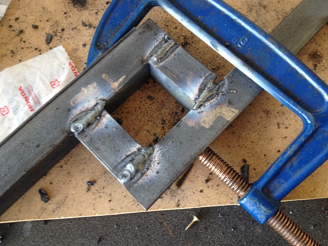

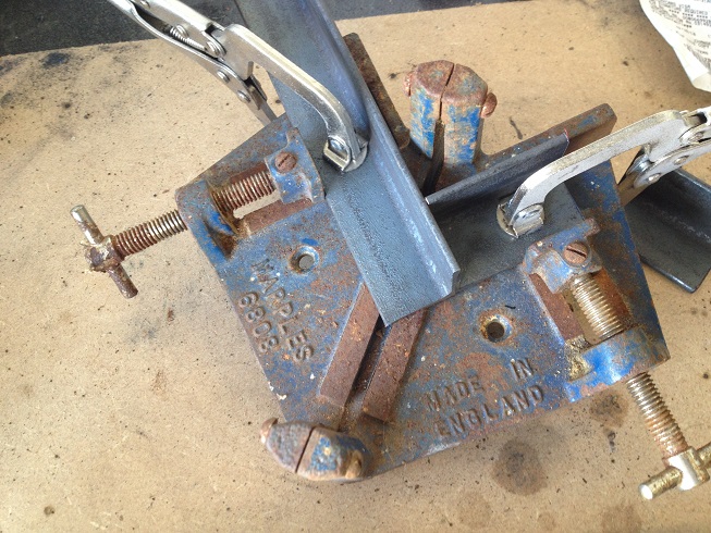

Post by eddiebpool » Sat Apr 15, 2017 9:44 am
I done the best I could with my typically crude and over engineered way. I started off with some 3mm angle steel and cut the long parts 300mm for a bit of leverage and the short parts 55mm to give a little wiggle room on the inside. I have a vintage clamp to create 90degree angles. I created two "L" shapes with the old clamp, g-clamped them together then welded them up. Please don't judge my ratty welding, it isn't my best skill!

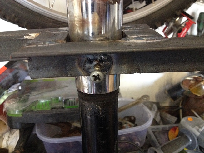

Post by eddiebpool » Sat Apr 15, 2017 9:52 am
I was planning to do a 4 sided tool. I started with 2 but after trying to line up number 3 I made a mess of it. I had a workaround if I wasn't getting ongoing the grip or if the studs broke. 3mm steel doesnt give too many threads or lateral support so i welded on a couple of nuts to be sure, In the end I didn't need more than two studs. After a good roasting and a little bit of force both came off without much complaint. Job done, pics below.
