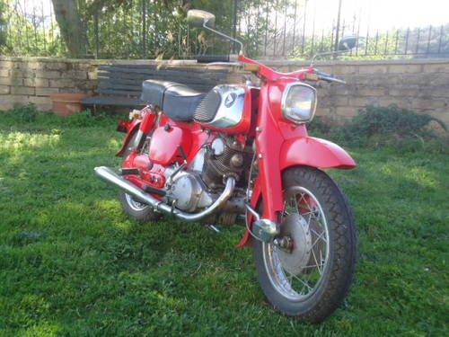

The pressed bars don't come up often as even the C77 models changed to the high tubular bars around '63-'64.
I have several pressed-bar C72s that will get rebuilt over the next few years but no spare handlebar parts. Traditionally those pressed bars come with winkers of one variety or another, depending on the country they were intended for.
These were intended for Germany / Finland.
This is the more traditional type the UK got...
In your case, I think that a set of CB72 straight bars would be easier to deal with as you could just transfer the existing controls.

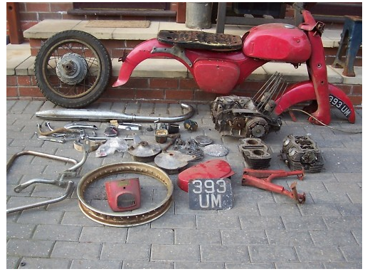

I bought this 1960 Dream pretty cheaply but it has a lot of parts missing.
Honda C72 DReam 1960
Screen shot 2011-03-22 at 21.14.57.png (352.93 KiB) Viewed 1838 times

Post by Svenskabru » Thu Aug 03, 2017 7:45 pm
G-
I see what you mean. The stamped bars are there, but you have a lot of missing bits, just on the bar controls alone. Let me know how it progresses, I'll go with chrome steel tube bars that match the geometry. Much easier to find the parts to go on a 7/8" steel tube.
