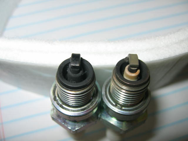

Here's a photo of the spark plugs after yesterday's ride. Right side looks to be normal and healthy, left side a little sooty. Both carb needle clips are at the center groove. I'm not sure what to conclude from these plugs...anyone care to give their opinion?
Re: Addendum to yesterday's
COMPRESSION/TIMING. ...........lm
Loudo wrote:Here's a photo of the spark plugs after yesterday's ride. Right side looks to be normal and healthy, left side a little sooty. Both carb needle clips are at the center groove. I'm not sure what to conclude from these plugs...anyone care to give their opinion?

Discovered my left side intake valve clearance was WAY too large. Don't know what happened there, perhaps I didn't tighten it down or at least not enough. Just a ticking now, not a loud tapping. Maybe that was it...who knows? Wants full choke to start now, the throttle stop screws can now actually be used for their purpose, maybe the bike's getting dialed in better. I'll take it out for another decently lengthy ride to check it out if it ever stops raining.

Bike ran very, very well. Sounds really good, idles fine. No oil leaks, nothing weird. Pulled the plugs and they both look excellent...tan cones, etc. Just like the "normal plug" in a plug condition chart. All in all a very pleasurable ride.
