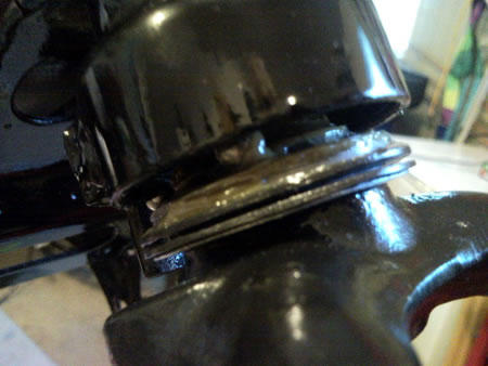

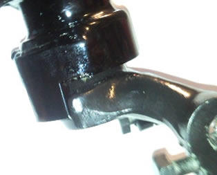

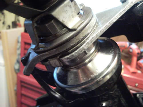

nc_rider wrote:I'm still pondering this one.. if I take the damper and everything above the plate off and line it up with the top of the forks then it's not even close to being in alignment with the nut on top of the steering stem. Bending the plate wouldn't correct the situation...
So I started looking at how the forks are attached the stem and noticed that the steering stops don't quite line up. I'm not sure they're supposed to fully line up, but it seems like they should. To do that the stem would need to go up into the head tube about 1/4" more and I'm just not seeing how that's possible. See photos below..

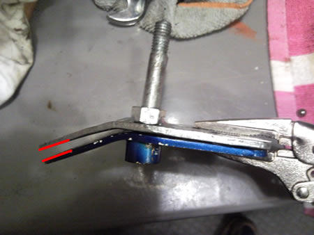

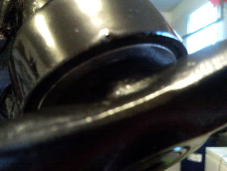

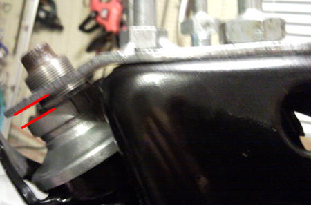

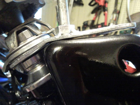

nc_rider wrote:Thanks for the photos Clarence! That helped me clear up some things and pushed me to look back at the bridge plate as the culprit.
Take a look at the photos below and you'll see that I dug around in my boxes and found another bridge plate from another year to compare with. What I'm seeing is somehow the bend on the original bridge plate is not quite right. My guess is a PO assembled this by bolting the plate to the steering stem and to the top of the forks then rotated the forks down until they could fit the bolts in the lower part of the steering stem.. I'm sure it fit fine like that, but it put a lot of stress on things as that bridge plate acted like a spring.
Is there any way for certain to know that I've got the right bridge plate/fork/frame combination here? I can rebend the bridge plate to make it fit, but I would rather know for certain that I have the right parts to begin with and I'm not just forcing somebody's wrong parts together. This is a '64.. with "early" clutch cable routing, and I'm beginning to suspect that somebody put a "late" bridge plate and forks on it and there's some difference in how they fit.
One thing is for certain.. I'm finding out that the POs put things together wrong, left parts out, bent things, etc.. so I can't rely on the "before" photos at all with this thing because it wasn't right.
