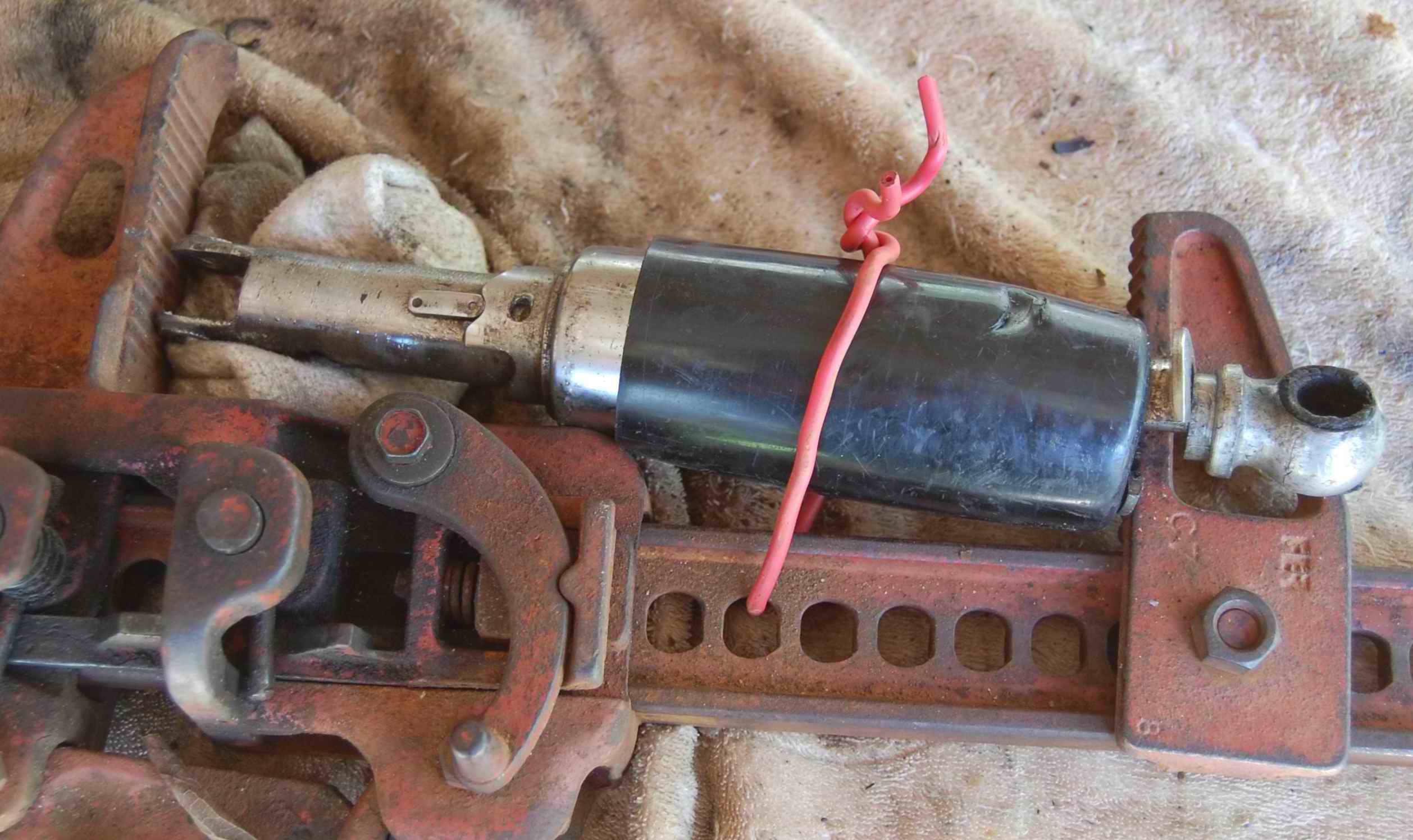

here's how I got my old shocks apart, may give you some ideas. Somebody said they used a Work-Mate bench to do the same thing, others have done it with a variety of other tools and techniques. I used a lot more padding and care to get the new ones back together. good luck, Lee

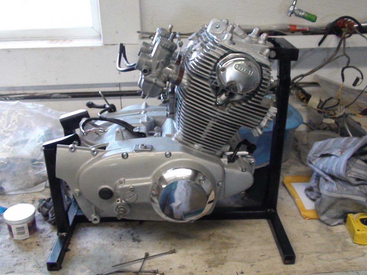

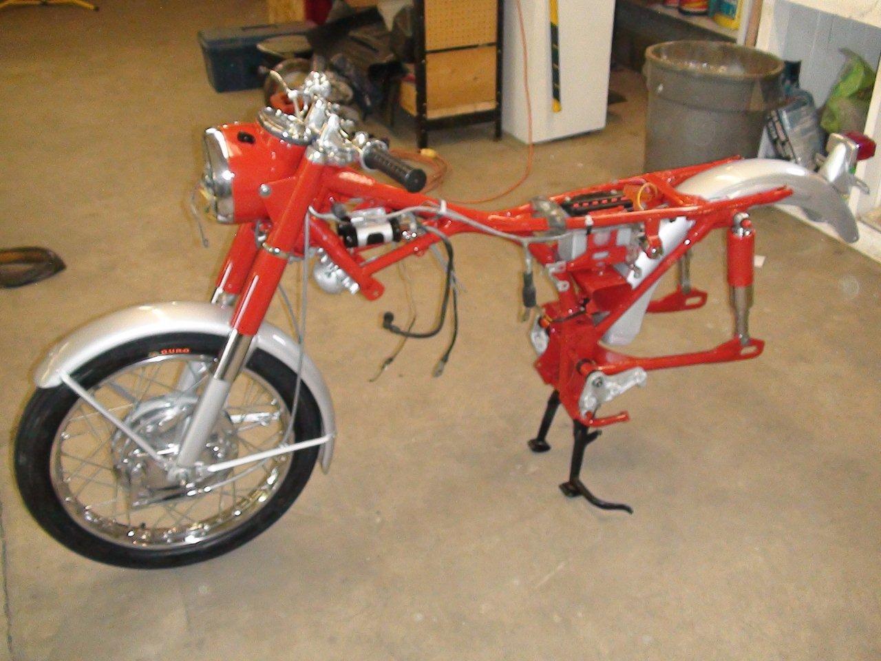

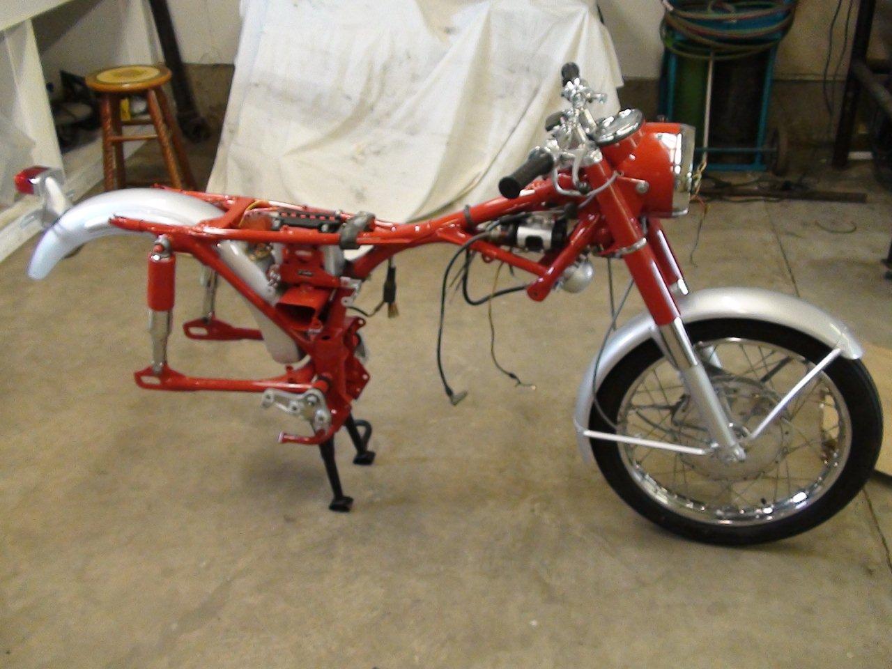

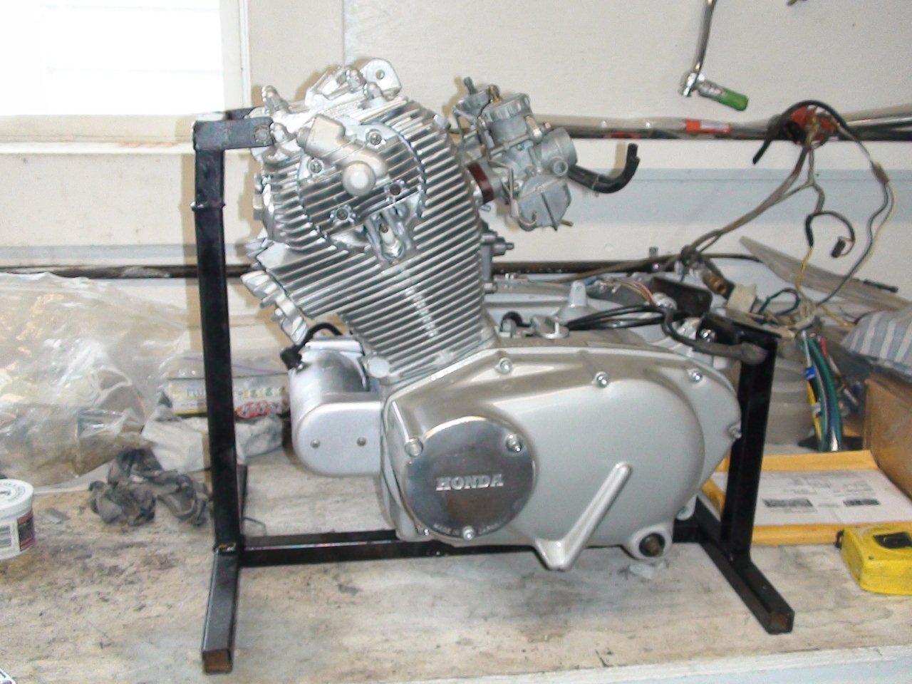

Finally got almost all my pieces. Enough to get started putting everything back together. I bored the cylinders and put in new pistons and rings, new valves, all new seals, replaced any bearings that needed it, shimmed the tranny, rebuilt the carbs, new points, cam chain and roller, all new sprockets and chain, new tubes and tires, wheel bearings, cables, new repro mufflers, and everything that can be painted or polished has been. The pictures are off a little colorwise, as I din't have the white balance set properly. The red is a fire engine red, but it looks a little orangey under the flourescent lights. I'm just waiting until I can get a hand to install the engine. The last thing I want to do is drop it at this point!
