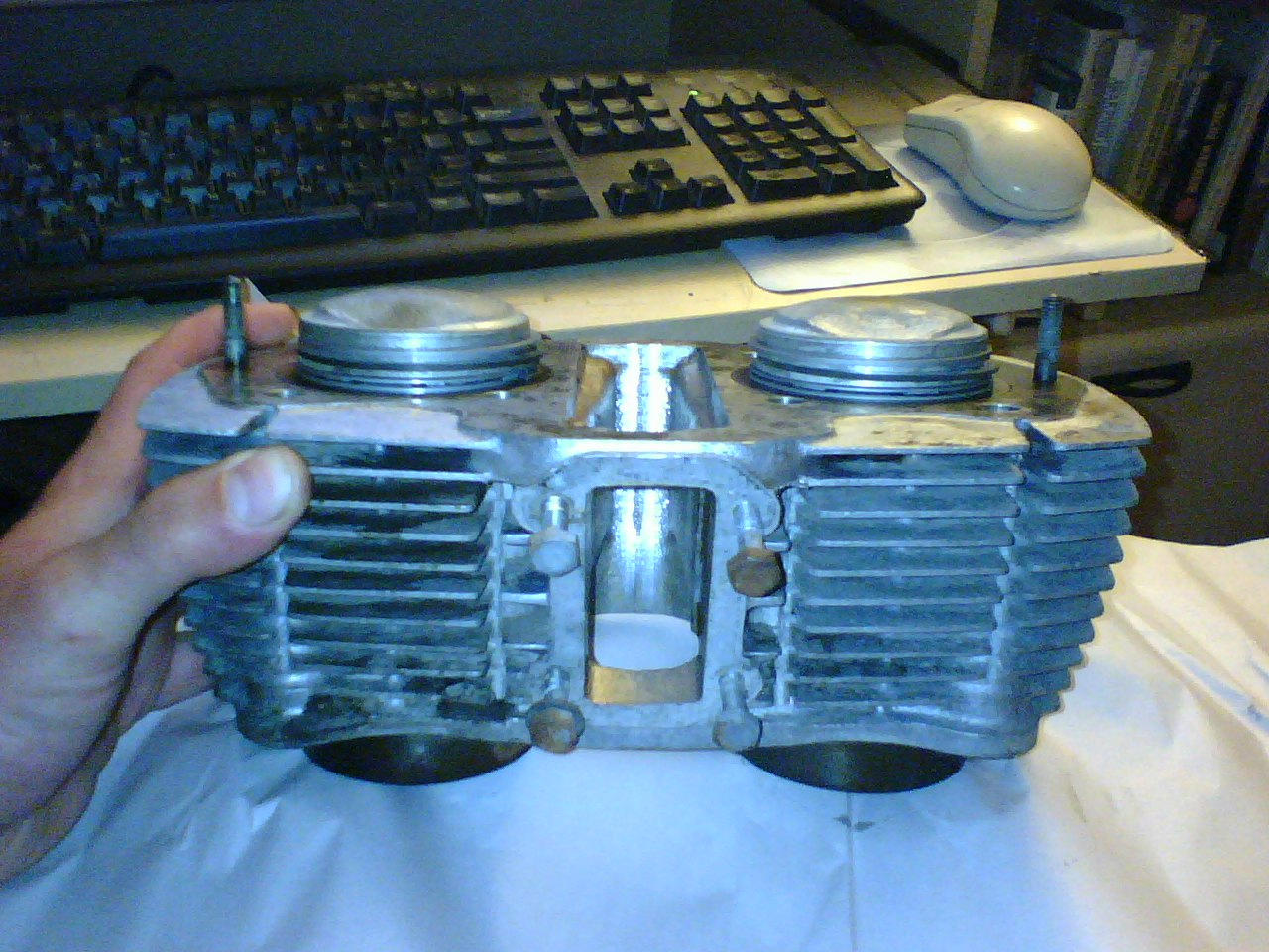

Mine has been waiting on my cylinder which was finished today (Pic below)... I had it bored .25 over to match my pistons (Thanks Ed for the pistons and rings!) I'll be building tomorrow so I'll post pics of the completed engine tomorrow night if all goes well.... I was curious about your piston set up... are those custom or does Wiseco sell cb77 pistons? I am also planning on glass blasting mine... My only concern is that once blasted it'll become a maintenance issue to keep it clean... With such a rough surface I would imagine it would attract and hold any oil grease or dirt it comes into contact with... I've even considered using pure vinegar instead to clean it or to blast it and then spray the lower with a clear coat... what are your thoughts on this?
Cylinder just back from the Machine Shop w/ pistons resting in the top of the bore...

Mac, Wiseco does make pistons for the 305s. Tim McDowell sells them on his website. http://www.classichondarestoration.com/ ... _Parts.php
The glass beaded sufaces are a bit rough, and do attract dirt. They clean up pretty easily, but will get dingey with time. I've thought about clear coating over the bead blasted surfaces, but have not tried it yet. I plan to try it on an engine sidecover in the near future. Good luck with the build, and keep the pics coming.

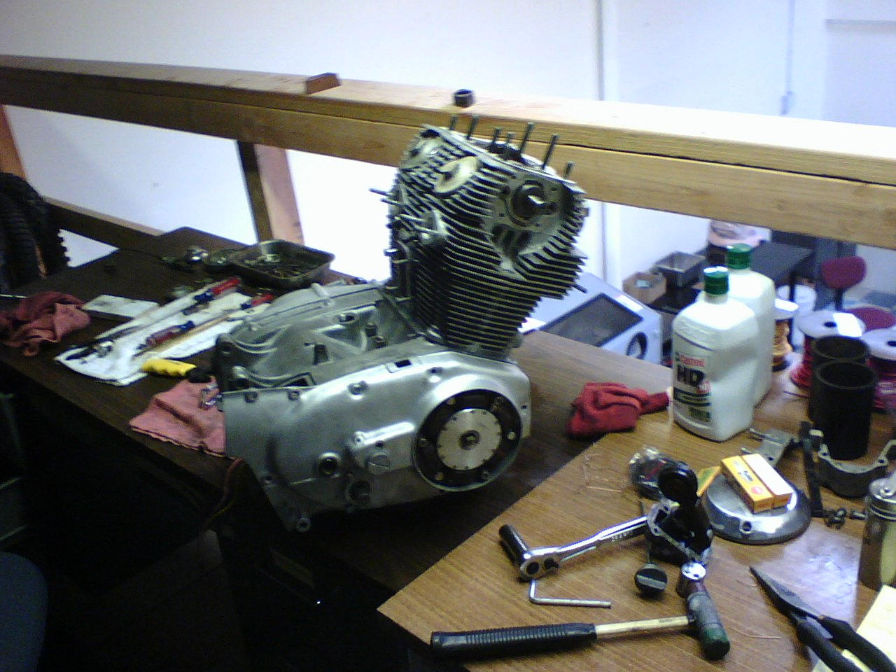

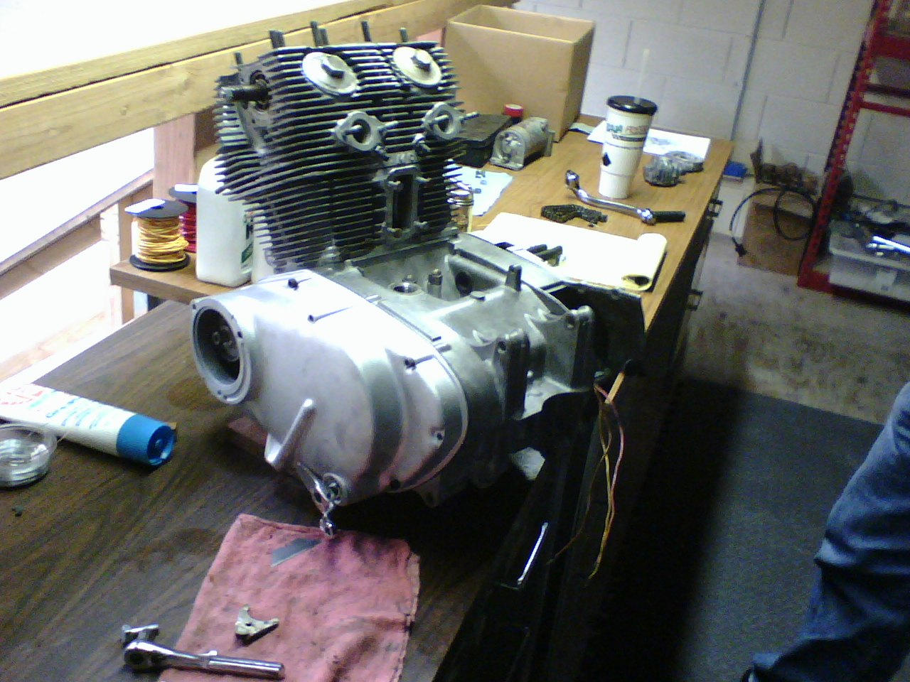

below are some pics of the mostly complete engine...
