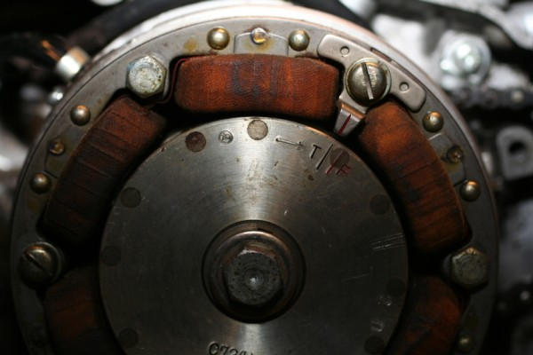

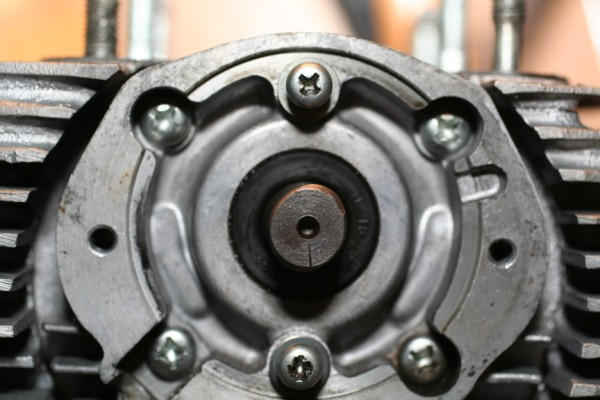

I pulled the engine as you suggested. From the way it appears to me I have 2 of the 3 criteria for correct timing. The flywheel is set to "T", resulting in the cam sprocket being level but the mark at the points is still off slightly. I did not know about checking the mark at the points when I reassembled it last time but I was sure I had gotten the sprocket set level. See pics below. I have checked to springs by twisting the cam and it seems to move freely and return to position correctly when released. If I am interpreting everything correctly it seems like the timing might need to be adjusted towards advanced a little bit. Could this be weak springs? Is there any adjustment that can be done? Other ideas?

Since the timing chain idea didnt work out I have now reassembled the motor as it was but with one modification. I opened up the guide channels on the point plate to allow it to rotate further around than had previously been possible. Early indications are that it is an improvement. While the timing light still doesnt quite fire at exactly the "T" mark, it is now about halfway between T and II...much better than before. It advances to about II upon revving. The smell of urnburnt gas is gone and the plugs dont seem to be loading up after 15 minutes or so of running. I will try to get it rideable this week to see how it does under load but so far so good.
