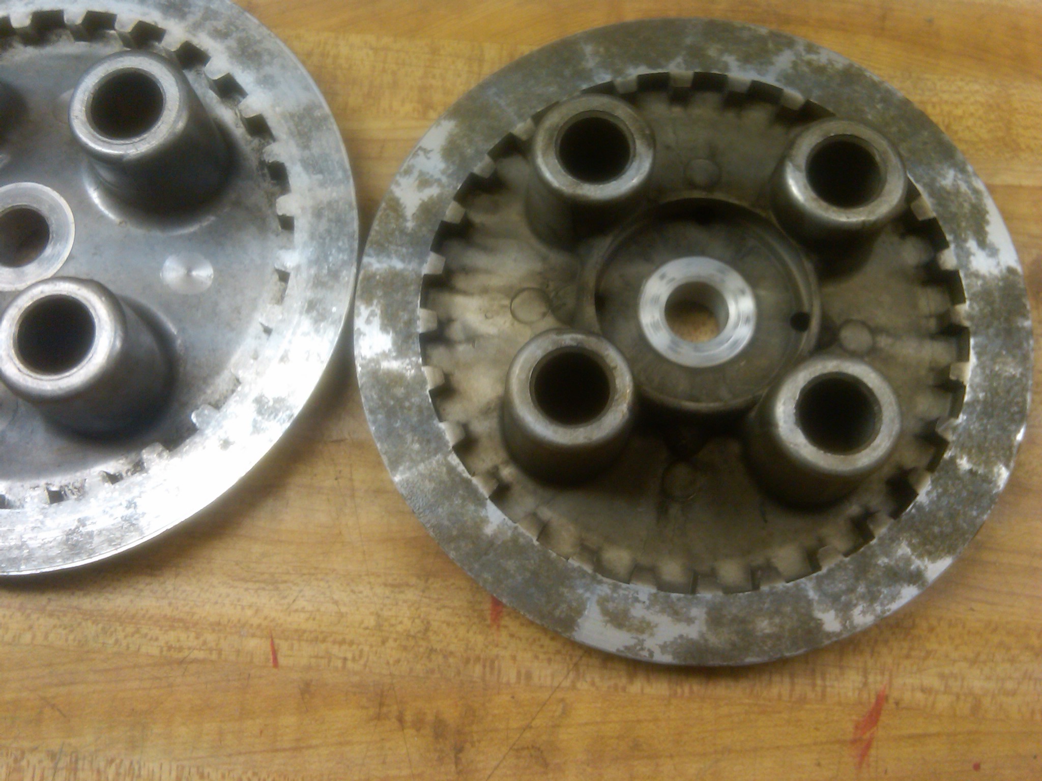

Can ya show the pressure plate?. .........lm

Post by OldStan » Sat Apr 23, 2011 7:06 pm
Here you go. I haven't cleaned it up yet, all the clutch plates were stuck when I got it.
Old Pressure plate on the left, "new" on the right

Post by LOUD MOUSE » Sat Apr 23, 2011 8:37 pm
It is a Cush. ...............lm
