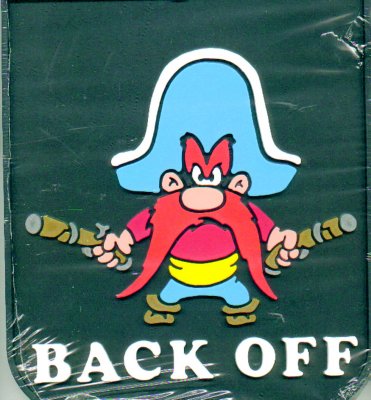

Christmas in May.
Today I received:
mud flap (thanks Joe P.)
chain guard (thanks Bill S.)
front sprocket (thanks Kevin H.)
Waiting on seat from Thailand. Badges due in too.
Fixed my nacelle light switch issue. The thing looked newish but had old hard grease shorting out the contacts. A rebuild and it works fine. I now have headlights.
Right carbie leaking fuel (slow drip) ... (it's not the petcock). Looking at bowl gasket to see if it hangs up float. Still running a bit rich ... cold starts without choke on a 60 degree day. Then it pops here and there.
I just discovered there are NO baffles in the pipes. Although it sounds gnarly, it's a bit loud for my neighborhood, and I'm concerned about proper back pressure and not running right. No options at the moment unless the wife has some old pantyhose I can stuff in the mufflers ;) Funny there are no obvious holes where baffle screws may have been.
Struggling like hell to get it registered in time for the VJMC breakfast and ride this Saturday. If not it's a trailer event (bah!!)

btw ... I know this sounds blasphemous, but I installed the mud flap, and I'm sorry but it looks kinda dorky to me ... (ducks). But w/e ... I'll leave it on for now.
