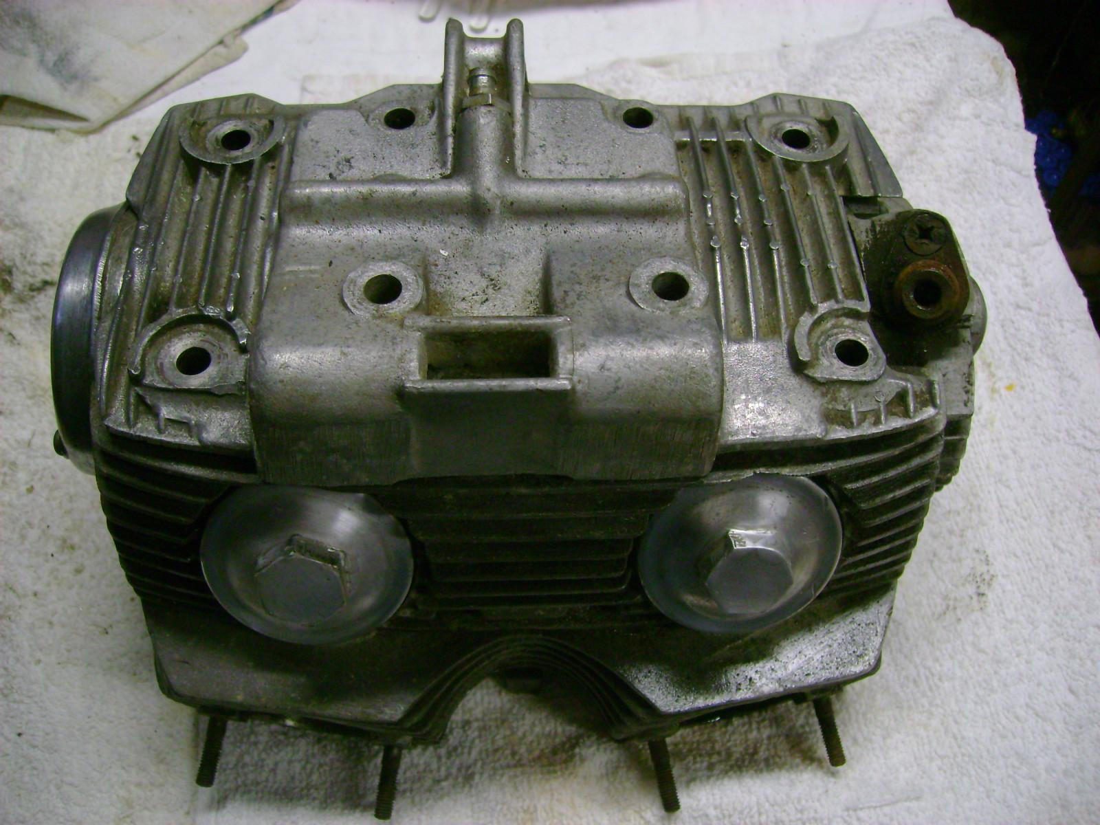

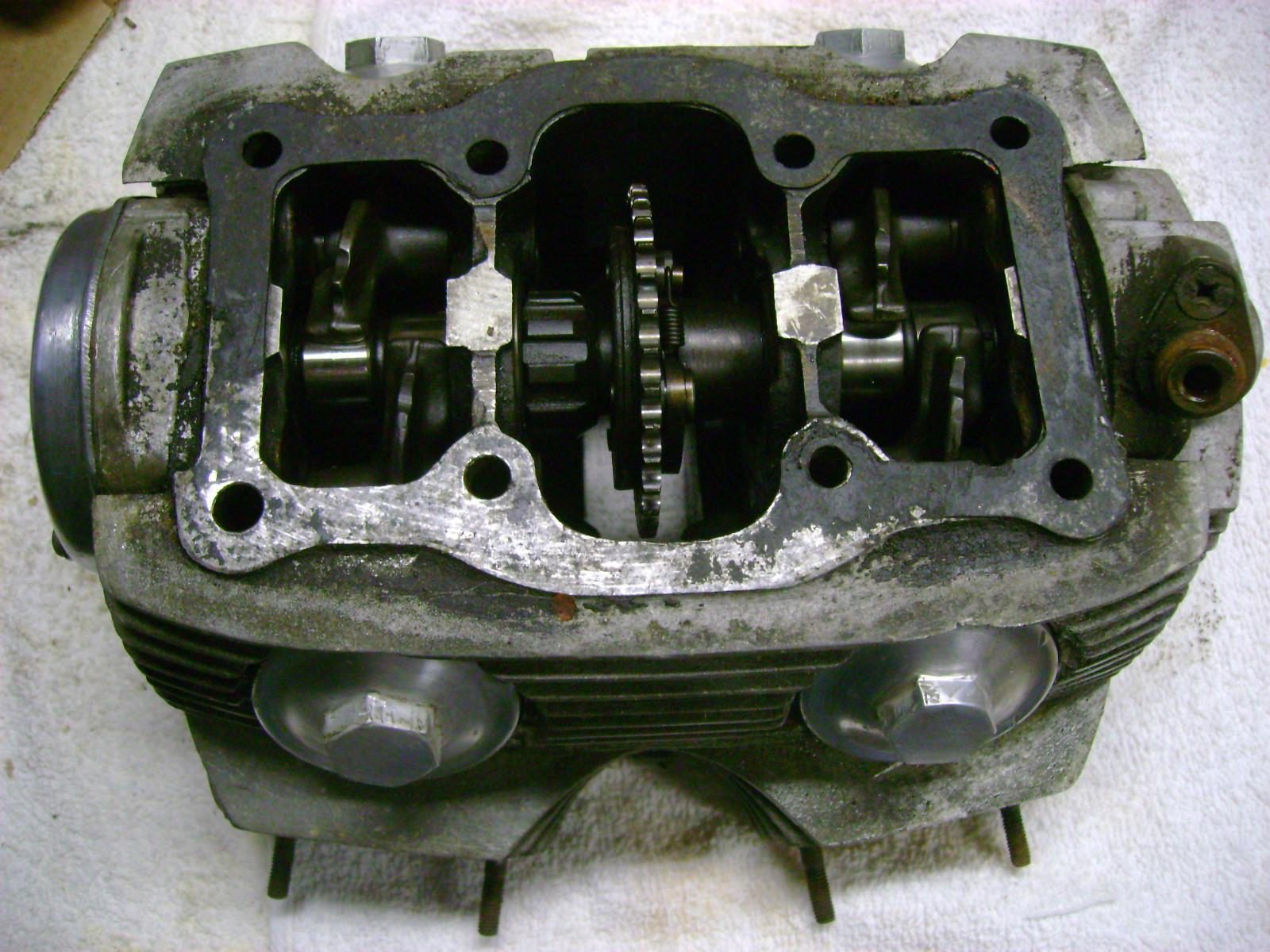

I bought a cheap head off Ebay last night, so I can see how everything is put together and learn how to disassemble the cam without experimenting on my own bike. This should help me get educated before I pull mine.
if anyone needs parts from this thing when I am done banging on it, please let me know.
