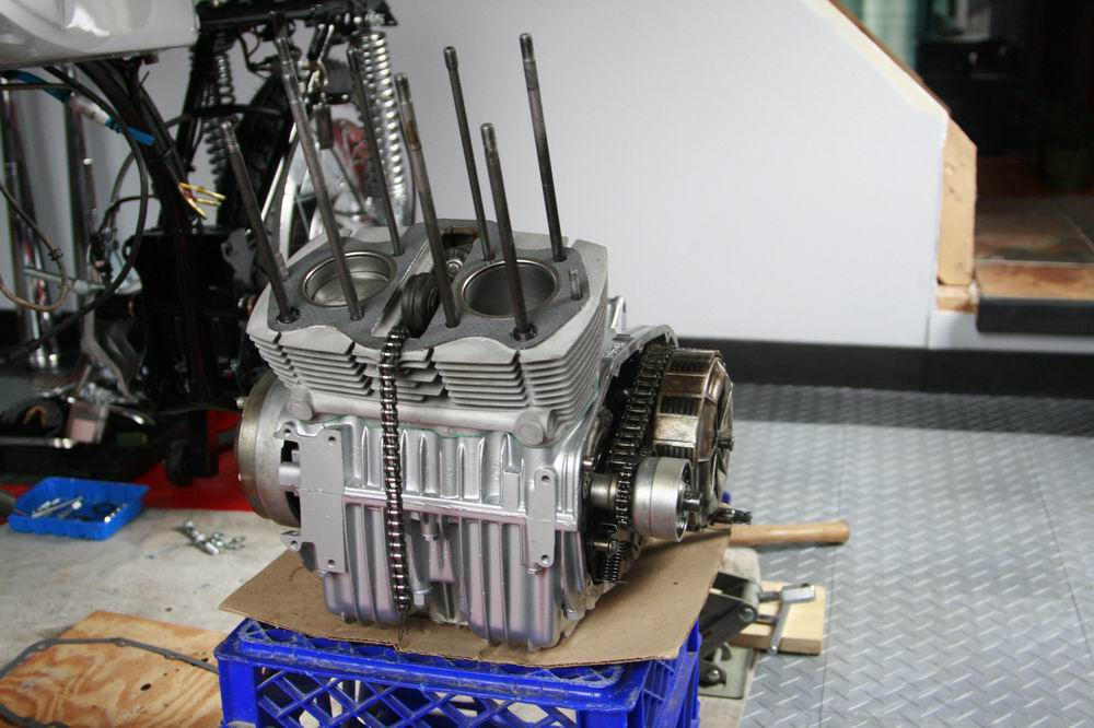

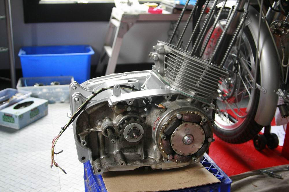

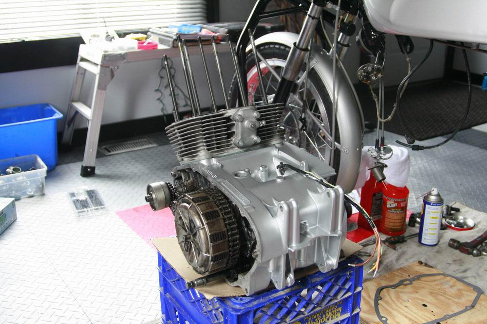

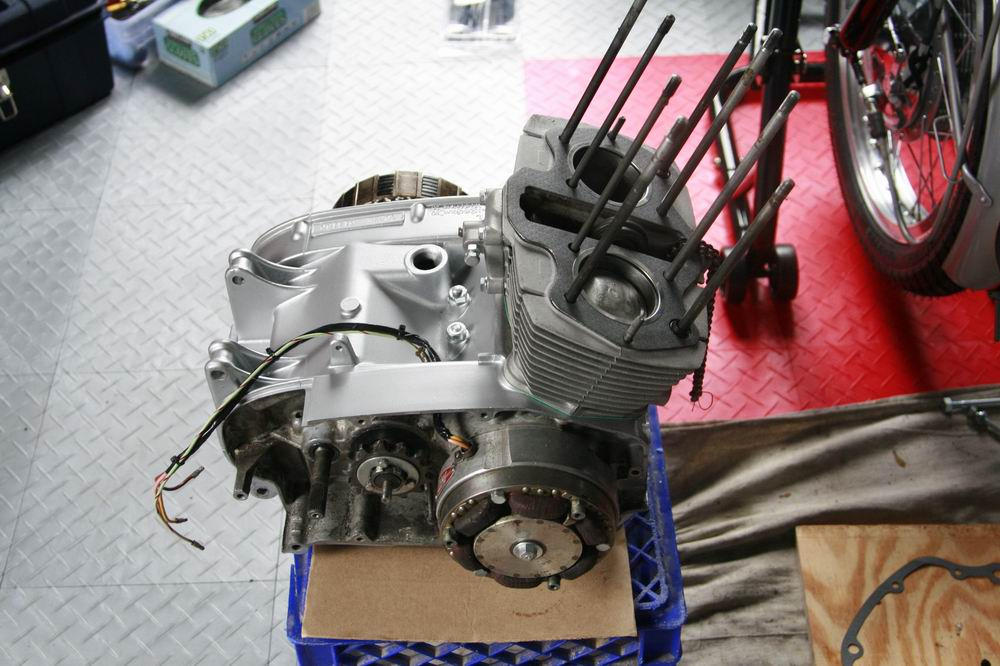

Post by eyhonda » Sun May 16, 2010 4:44 pm
Here, I've assembled the motor. Pretty straightforward and no issues. I had Phils Cycle do the valve job. Since I didn't have a valve compressor and I didn't have a good way to do a valve job, I had the shop do it.
