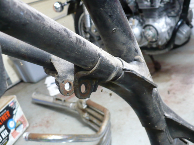

I finally got my frame stripped of parts and can now compare it to a 1965 frame. Steering head is smooth on the right side, the 1965 unit has a boss cast into it.

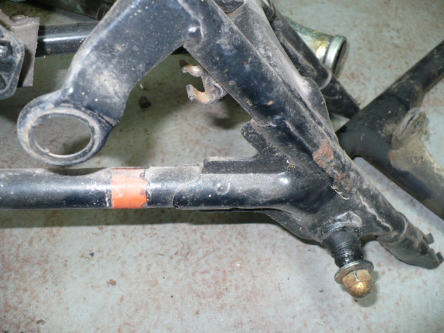

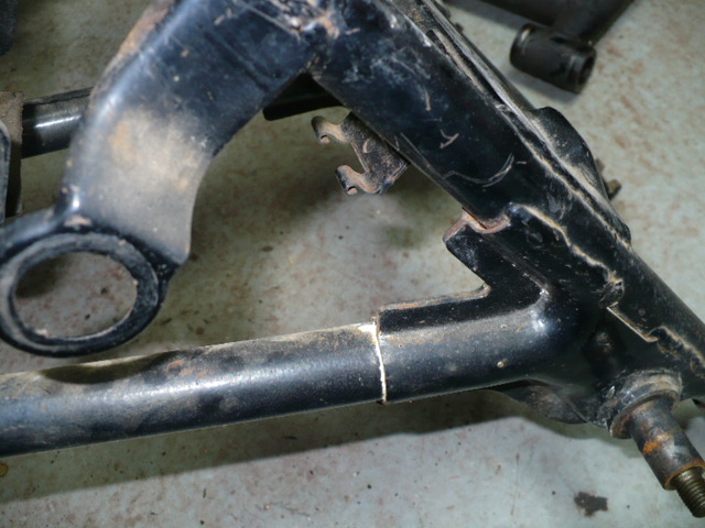

Post by Hoosier Tom » Fri Feb 11, 2011 2:08 pm

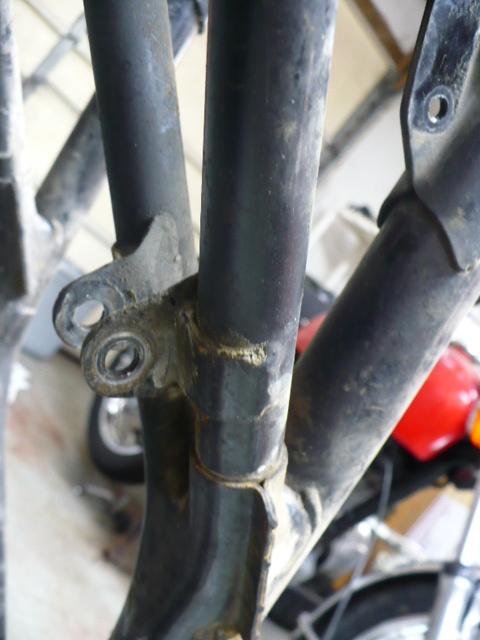

The rear top motor mounts in the later frame look to have been redesigned to strengthen them up. Maybe the earlier units were prone to cracking.

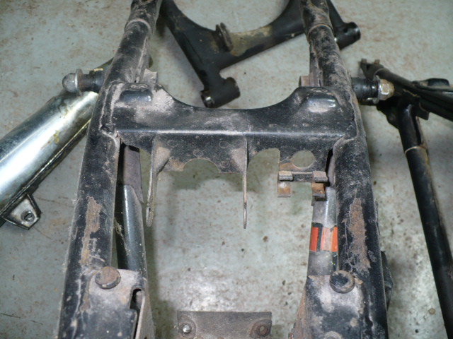

Post by Hoosier Tom » Fri Feb 11, 2011 2:15 pm

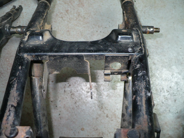

You can see they changed the fuse/rectifier attachment areas. On the 1962 unit the fuse holder is spot welded to a separate bracket spot welded to the cross member. The 1965 unit the holder is spot welded to a bracket that is a continuation of the cross member. The rectifier bracket was strengthened over the earlier unit by the angular stamping. I did not notice anny differences to the battery box/filter hanger assy.

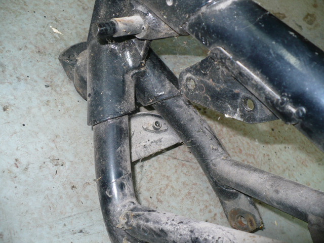

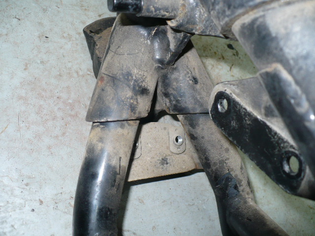

Post by Hoosier Tom » Fri Feb 11, 2011 2:18 pm

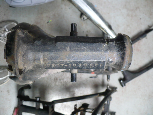

The rear shock casting shows some ears on the later unit where the frame tubes slide in vs the plain cylinder style of the 1962 unit.

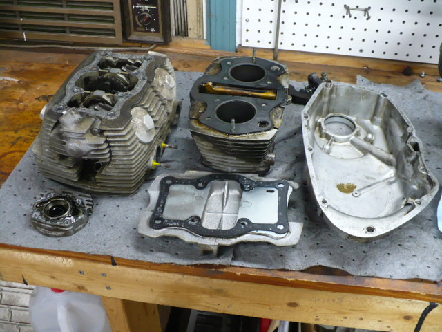

Post by Hoosier Tom » Mon Feb 28, 2011 4:20 pm
I'm getting my hardware ready to go to the zinc platers so I started tearing down my motor to get at the hardware. Like a dummy I forgot to take pics of the initial top end tear down to aid future newbies. I'll post what I got so far.
