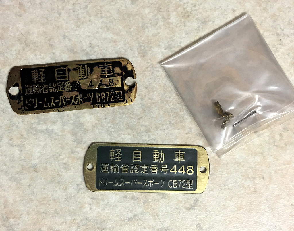

While I was away this beautiful model plate arrived from Japan. The original on my bike was damaged from rust bubbling away underneath and I was contemplating having a new one etched from brass. Luckily this one turned up....

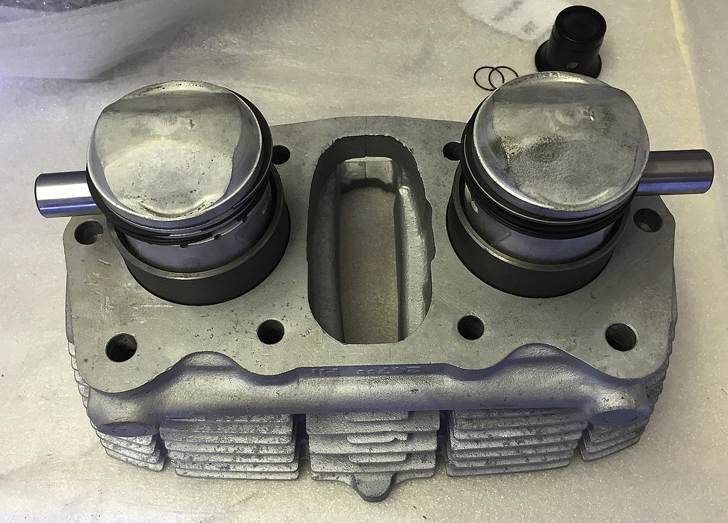

After my clumsy attempts to finish the speedo I was a little bit reluctant to get started putting the pistons and barrels on the '61 CB72 engine. I have days like this where I spill the sugar in the kitchen when reaching for something or drop things that I thought I had a firm hold on.
I decided to make a start and see how it went. I was anticipating dropping all sorts of bits inside my newly-assembled crankcases so I went slowly and took plenty of precautions.
These early engines have a different arrangement for oilways between barrel and crankcases so I made sure I had the correct gasket. This was given a light coating of silicone grease to ease its bedding in to the joint faces.
Then I carefully threaded over the barrel studs making sure I didn't tear it.
This is the different oil feed, where oil gets to the barrel and head via this feed next to the left front stud. Later models have an extra hole to do this job.
This engine is going together with the early 010 pistons which have a 9.5:1 compression ratio provided by a higher dome. I've never seen 000 pistons but wonder if those were 4-ring types like the early Dreams?

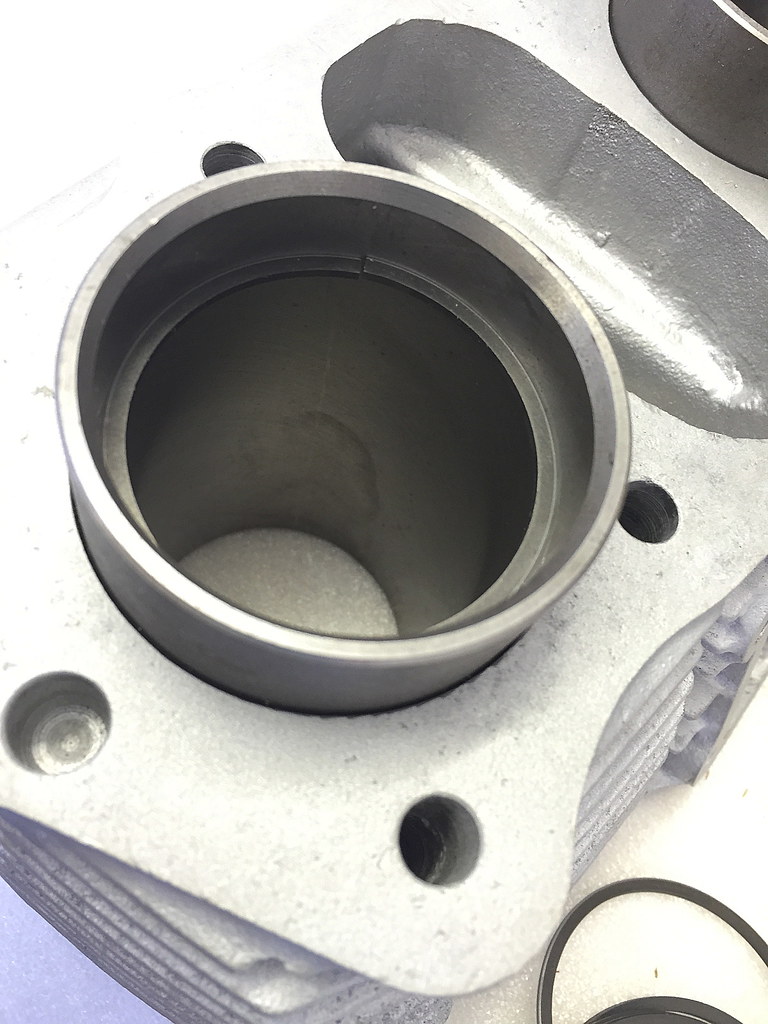

The ring gaps were checked by putting them in the sleeve and pushing them down square with the piston skirt.
For putting the piston rings on I just use my thumbnails and carefully ease them over the piston starting with the oil scraper first. Next the inner circlips go in so that only the outer, more accessible ones need fitting with the pistons in place.
It was really nice to just slide those wrist pins into place in my freshly bushed small ends. The pins pushed in with finger pressure and I blocked up the crankacse mouths before putting in the circlips.
I find the job of getting the rings into the bores pretty straightforward using just thumbnails and a small flat screwdriver. I oil the pistons and bores first, align the piston ring gaps at 120 degrees, set one piston at TDC and place a small pair of rubber handled pliers underneath to support it. The pressure of the studs in the barrel is enough to hold the barrel and stop it falling.
With that done I remove the pliers and let the first piston down with the barrel until I can engage the second piston and rings. A lot of people like to have a friend on hand to help with this process but I prefer to work alone, controlling the pace myself.
It was possible to rotate the crank with my hand and listen to the lovely 'swishing' sound of the rings working on those NOS Honda liners. A 54 year old bike on STD bore - that's a nice feeling.
