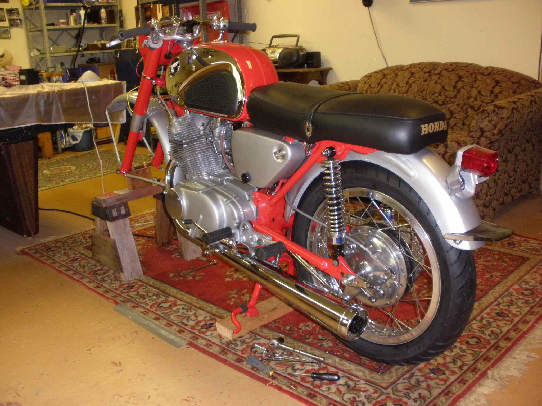

Post by maia » Sun May 30, 2010 7:24 pm
Still plugging away at it....the wiring is almost sorted. Turned the key on for the first time and a few odd things happened but I'm fixing them one by one. The starter spins it over which is a bit of a miracle since it was COMPLETELY rusted together when I took the end caps off. The armature was barely recognizable. It took a week to get it out and a couple more to re-furbish it. Just got the seat back from the shop which they had to refoam. The cover is from a fellow in Alberta, nice work. I found a new chrome strip off ebay which I will be putting on. The bolts that hold the strap on are toast so I'll have to come up with something to match the nicely re-chromed seat strap ends. Those bolts seem unobtainable. Have a sealed beam on order as the the one I had blew right away, must have had a leak or something. Last major job is building a new front wheel. I have an Akront alloy rim that needs some polishing then it will be an Avon Roadrider 90/90.

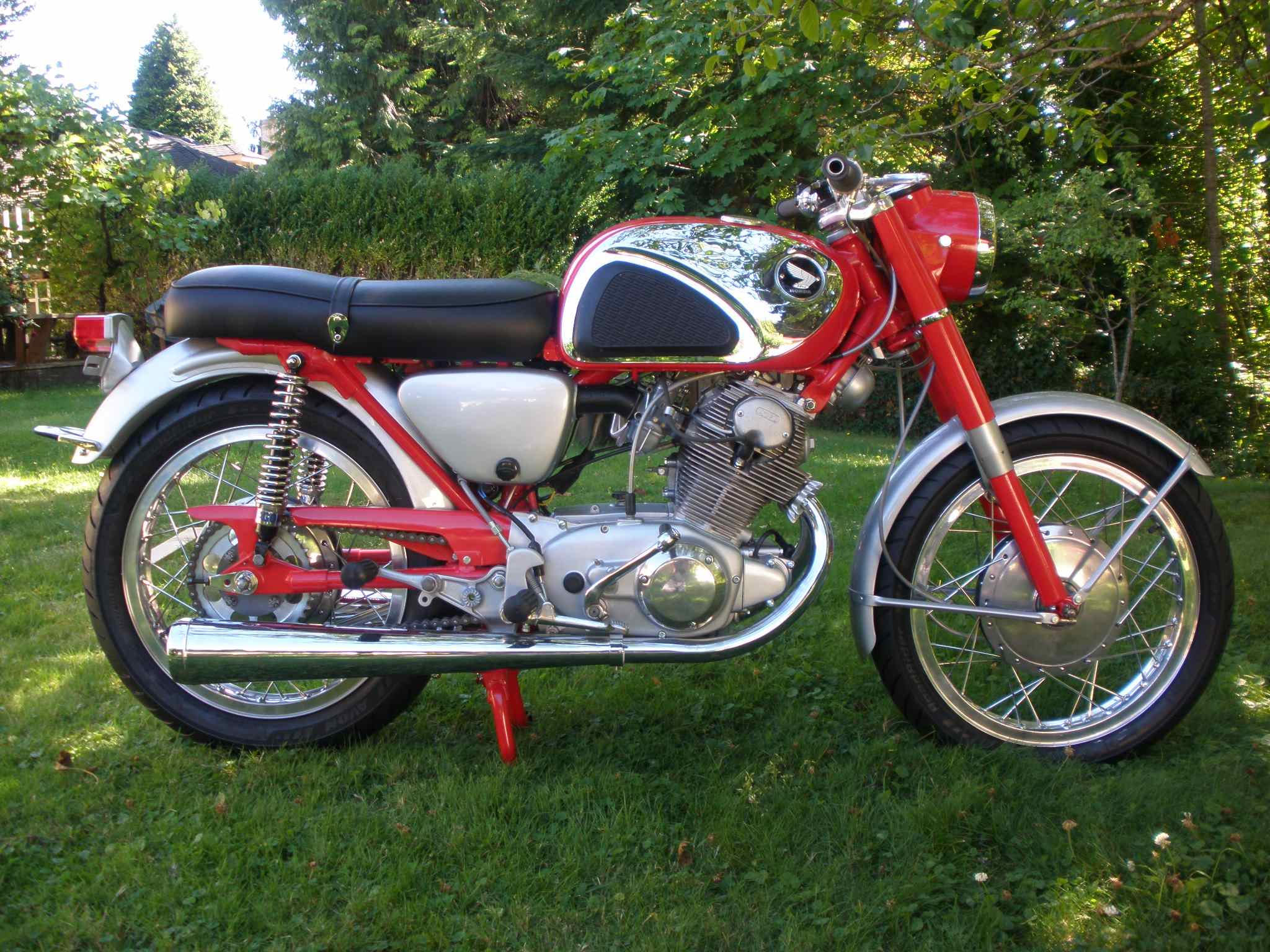

Post by maia » Tue Aug 24, 2010 10:47 pm
Front wheel built, a few details to look after then it's time to look for a spark.

Post by Tango911 » Wed Aug 25, 2010 8:28 am
wow amazing, i wish i had the guts to tear down and do a build like that. maybe someday.

Post by nc_rider » Wed Aug 25, 2010 11:07 am
looks awesome... can you give details on the alloy rims? Why did you use them (rather than the steel replacements found on fleaBay)? Where did you get them from?
... and what paint did you use on the engine cases?
