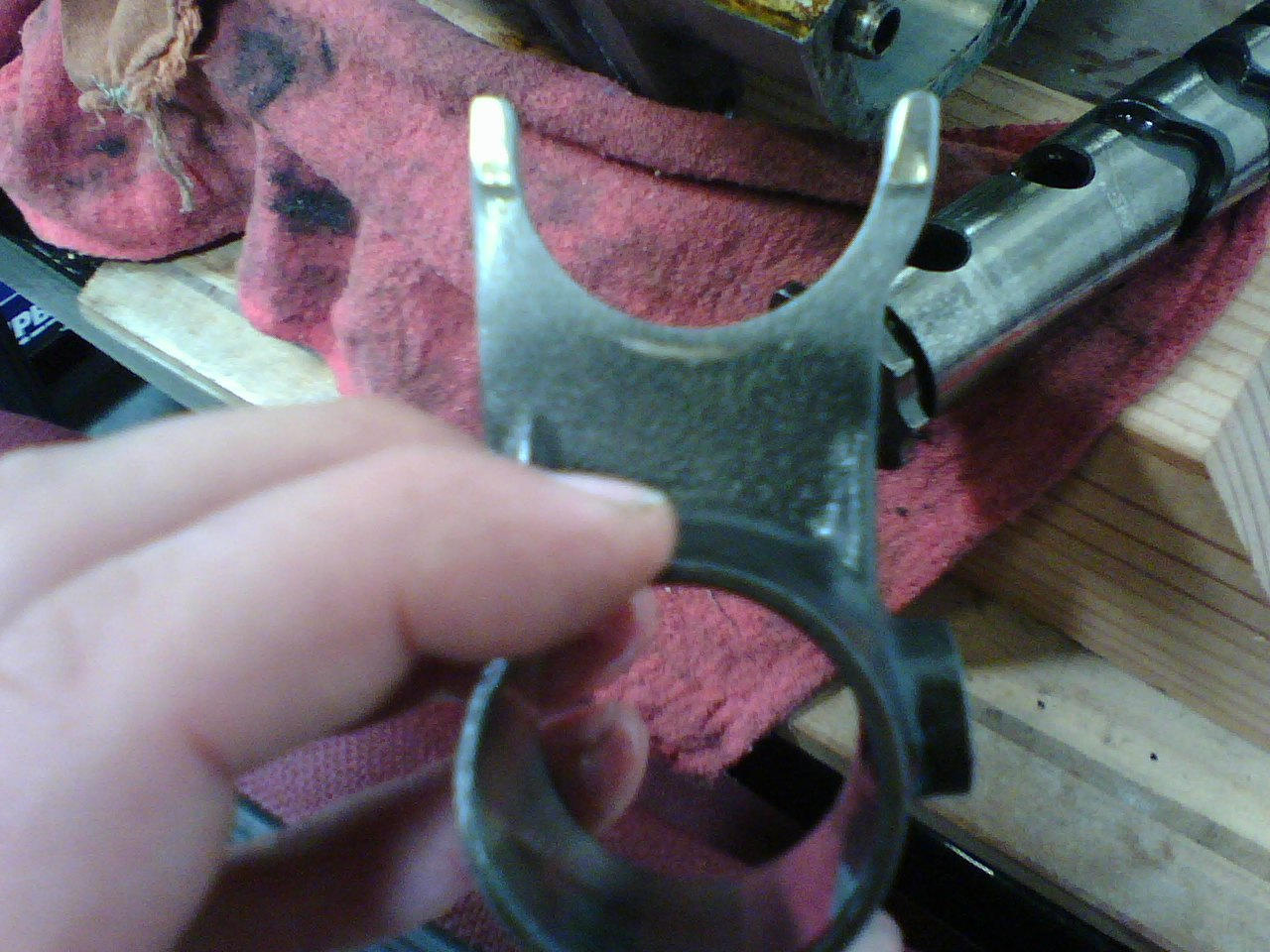

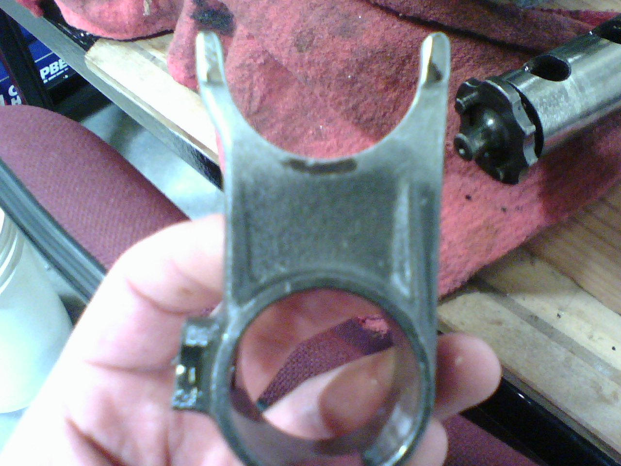

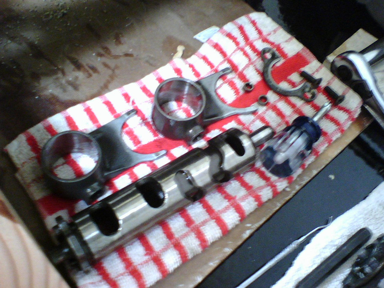

Only seeing wear at the contact points on each
Some wear on the right side of this guy...

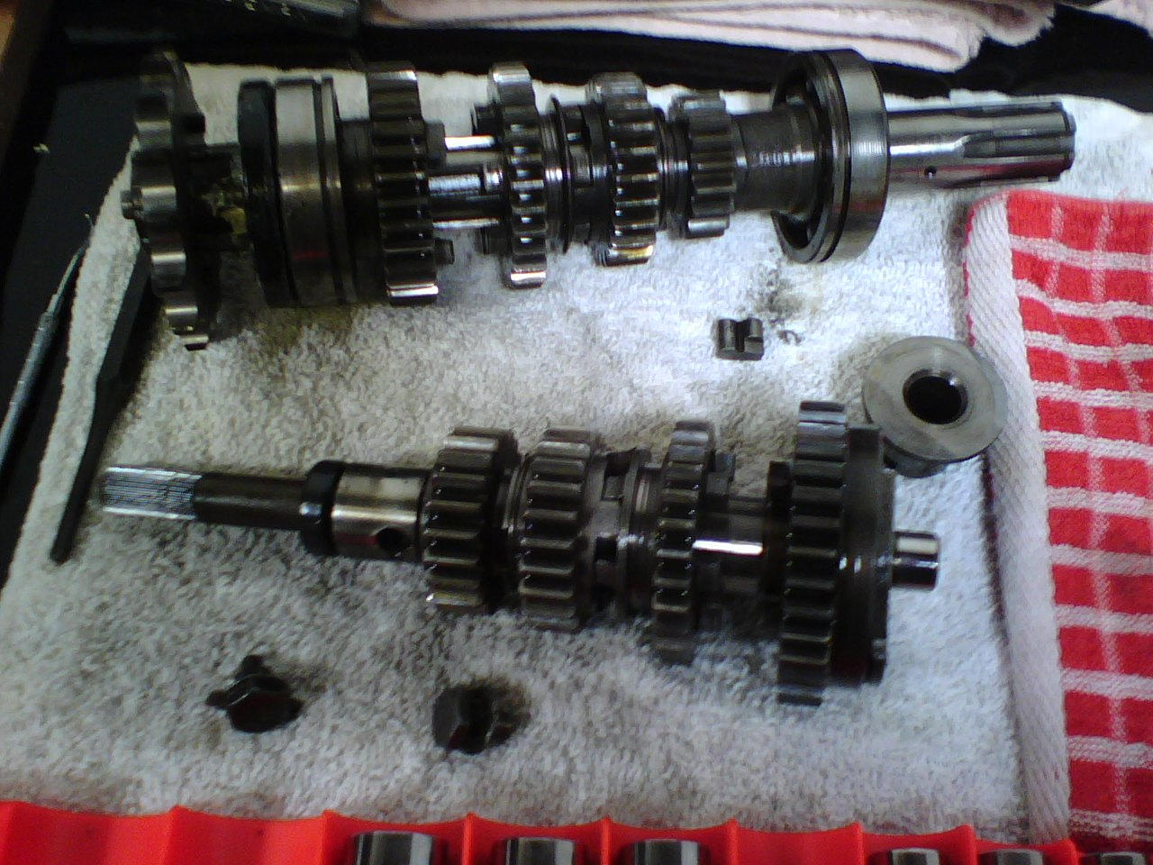

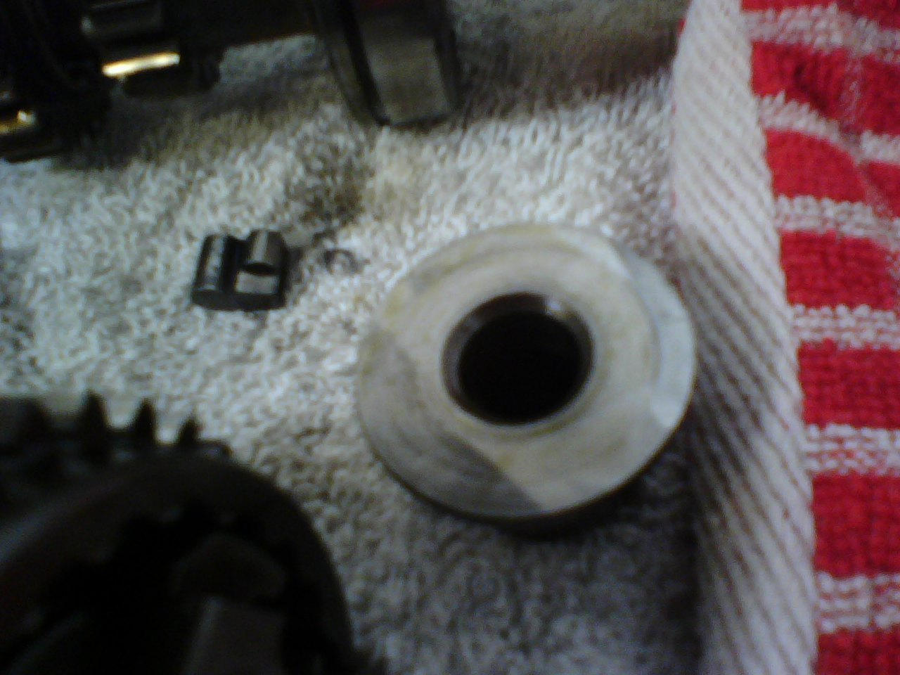

Lil doo dad (Technical term) fell out of this thing it's in afew of the pics...

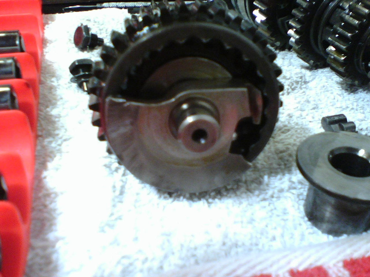

Some wear on the teeth of a few gears... mostly on the furthest right gear on the top shaft... also wierd lil doo dad...

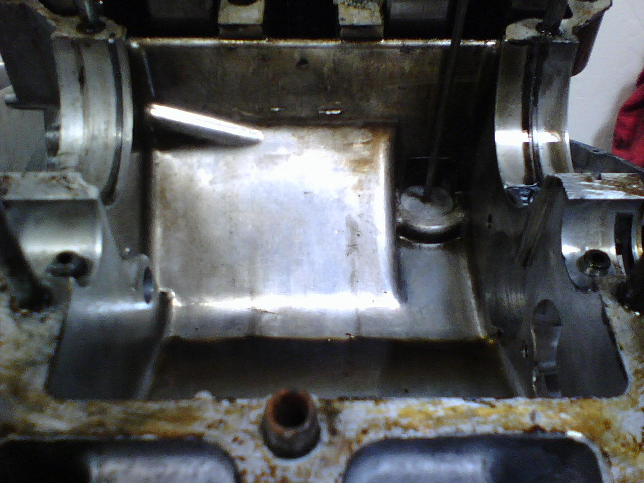

Dings in case from shit fork contact...

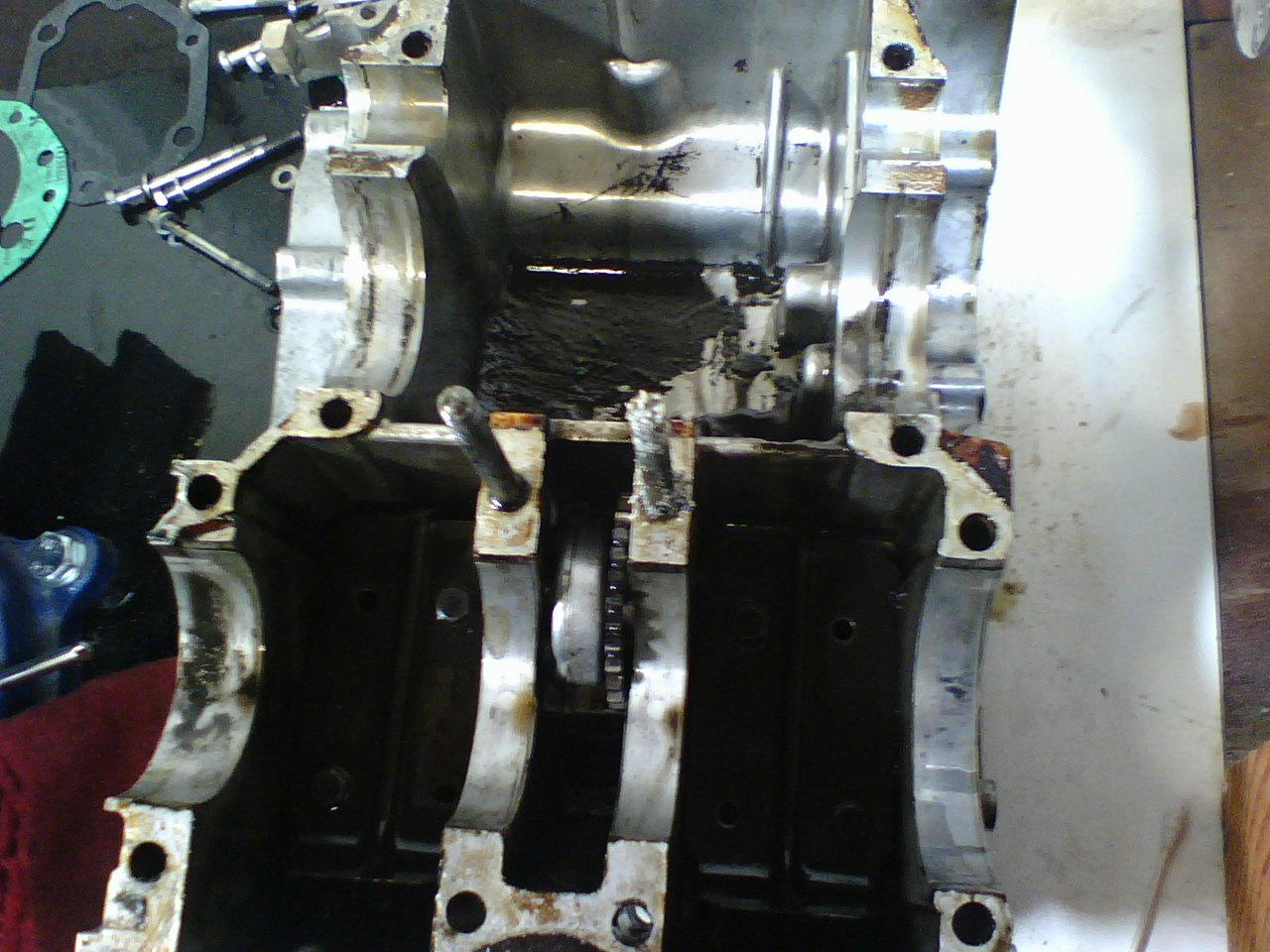

Stress crack found in lower case

Kickstrart pawl is little part that fell out and should be a spring also in there.

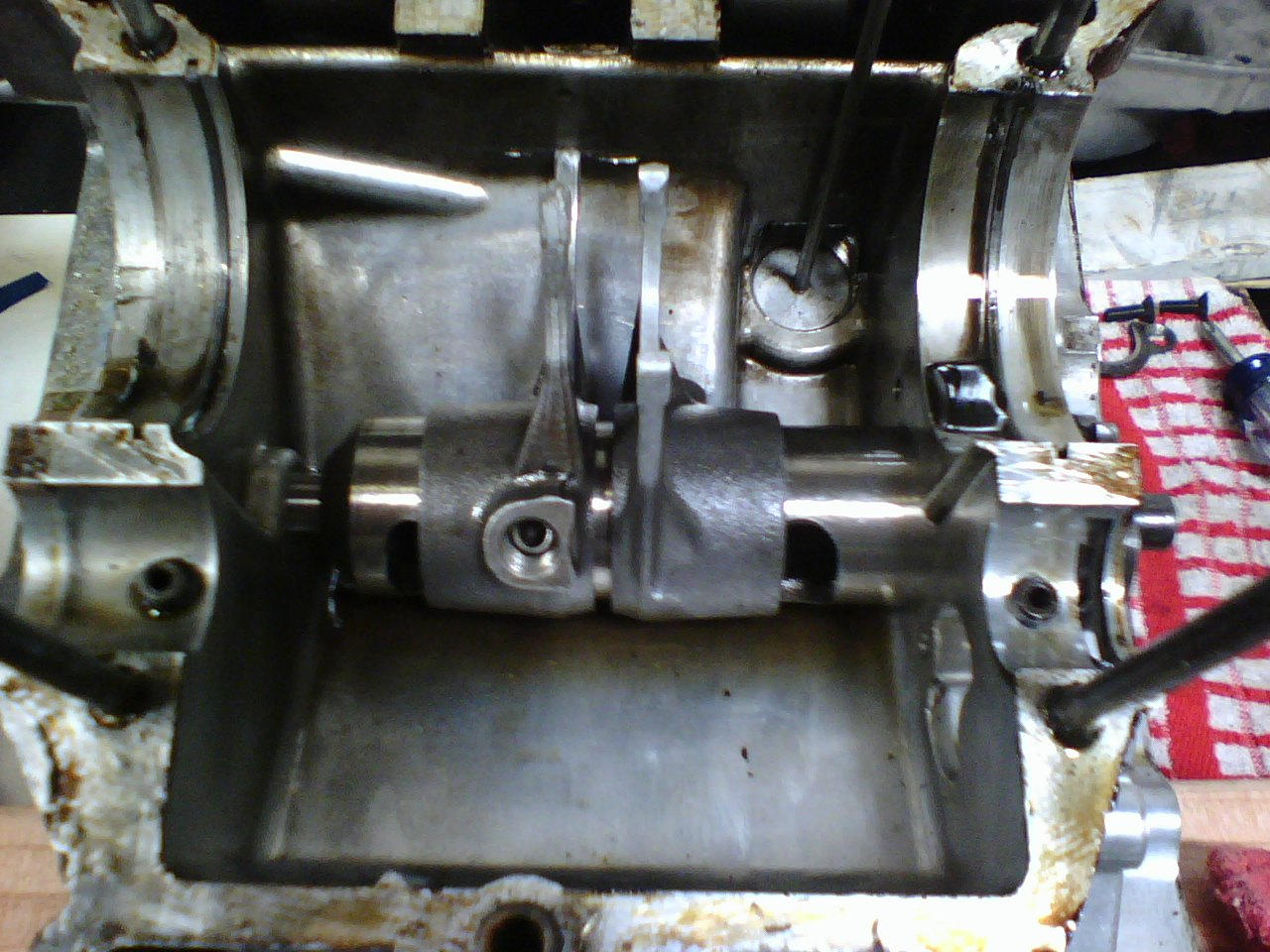

I believe that I found out what was causing this shifting problem... we'll se tomorrow... As I was putting everything back together I noticed that the shift fork that turns the drum gear had some interesting wear... upon further inspection I noticed that the bottom of the contact points were worn of at 45 deg angles causing it not to push the drum gear quite as far as it should and then would catch on it's return... I've found a new one and it arrived today... we'll see how it goes... I'll post pics tomorrow of everything... also if anyone else has seen this or has useful info please let me know....
