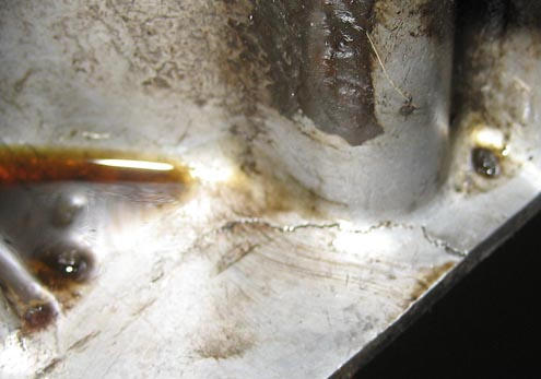

1. A crack in the right side of the lower case. Not in a critical area, but I don't want it to spread. It appears to have been caused by an impact on a fin on the bottom.

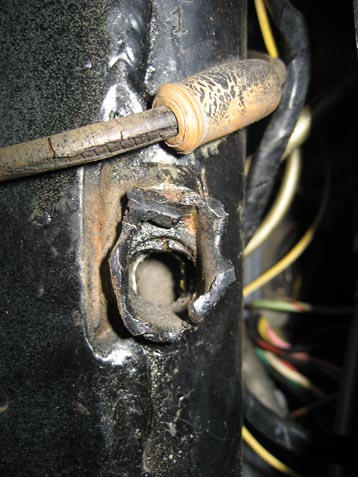

2. Apparently someone decided to take the steering lock out without using a key. I'm not sure what the boss normally looks like, but I don't think this is close. Is it worth the effort of repairing? The other choice is to cut it off and weld a plate in the hole to keep contamination out. Any thoughts on the best approach? Obviously any action will wait until a complete teardown.

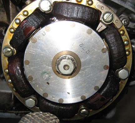

3. Missing insulation on the stator. I saw on another thread where silicone was used. How has that held up? I'm a little concerned about adhesion as here was a lot of oil in the side case. I don't want to use any strong chemicals, such as carb cleaner, to clean it off for fear of stripping the coating on the wires.

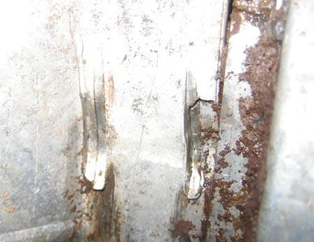

4. I found one screw broken off flush with the case ( no surpise here). The suprise was the boss broken for the rear center screw (sits in the middle of the chain, sorry, no picture right now.) How critical is this? It appears to have broken at the bottom of the threads. I would imagine this is not an uncommon occurance on a bike that's been sitting for many years. Has anyone come up with a viable repair?

I also read about the silicone on this outer wrap material so I tried it. I didn't do a lot of cleaning in fear of breaking off any more of this wrap. It seems to hold well the last time I had the cover off. I don't think it will hurt anything to leave it like it is, but the silicone will hold it together so it dosn't get any worse.3. Missing insulation on the stator. I saw on another thread where silicone was used. How has that held up? I'm a little concerned about adhesion as here was a lot of oil in the side case. I don't want to use any strong chemicals, such as carb cleaner, to clean it off for fear of stripping the coating on the wires.

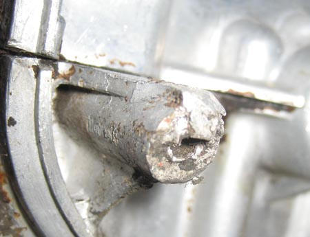

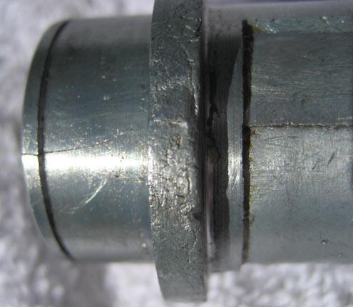

3. Okay, this is the important one (at least in this bunch.) I think this may be related to the major oil leak I had. The clutch actuator housing is cracked. There was no seal on it, which I'm sure would have helped prevent the crack. What really caught my attention is that the inner mechanism is extremely loose in the housing and would cock some when actuated. I'm thinking it was moving enough to put side pressure on the clutch rod and make the seal leak (seal was hard too.)
Is it possible that the inner mechanism is from another application? The looseness in the fit is definitely not from wear. Is there something missing, like a sleeve? All the parts breakdowns I've seen don't show anything.
