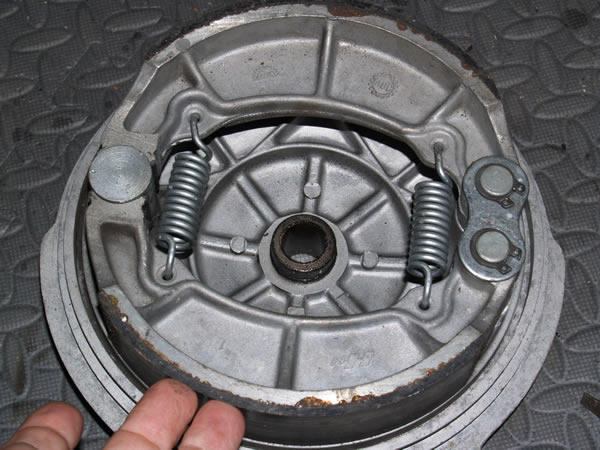

A few observations on disassembly.. the rear brake drum also showed almost no wear at all and had nice thick "hm" shoes. All wear points show almost no wear.. but... the front sprocket is worn. It's a mystery. Maybe someone rode it without oiling the chain then only replaced the rear sprocket and chain?? Maybe someone took it all apart and lost the sprocket and put a used one on? Who knows.
photo is the way it looked when I pulled it off.. no cleaning on it.
