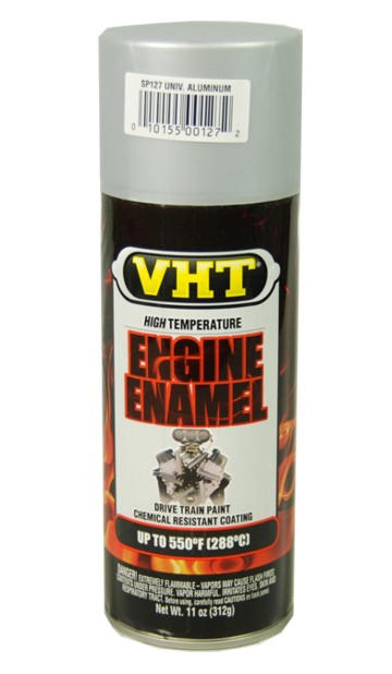

What paint is that on the motor casings and the valley cover? Is it fuel resistant?

That's VHT "Universal Aluminum" SP127 on the engine side covers, valley cover, and starter parts. I experimented with half a dozen different paints including the Krylon, Rustoleum, etc. and the VHT was the winner hands down in terms of color and fuel resistance. It has to be baked for an hour at 200F, but after that if you spill gas on it, it wipes off leaving no trace. Not sure how it would be with a continuous drip, thats why I put the fuel overflows on for a while until I gain confidence in my floats. I just Googled it and TCP Global and Amazon both have it in stock now if you're interested. Not sure about Spain... Thanks for the tip on the emblems, maybe I'll ask Santa for those!

48lesco wrote:That's VHT "Universal Aluminum" SP127 on the engine side covers, valley cover, and starter parts. I experimented with half a dozen different paints including the Krylon, Rustoleum, etc. and the VHT was the winner hands down in terms of color and fuel resistance. It has to be baked for an hour at 200F, but after that if you spill gas on it, it wipes off leaving no trace. Not sure how it would be with a continuous drip, thats why I put the fuel overflows on for a while until I gain confidence in my floats. I just Googled it and TCP Global and Amazon both have it in stock now if you're interested. Not sure about Spain... Thanks for the tip on the emblems, maybe I'll ask Santa for those!

Cool, thanks for the heads-up, Chuck.
