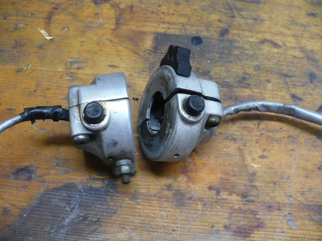

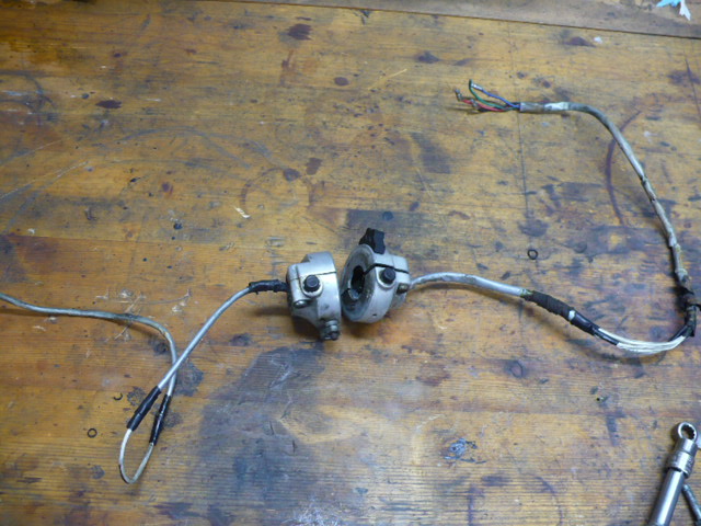

Post by Hoosier Tom » Mon Jan 31, 2011 5:11 pm
This bike had the original flat bars replaced with aftermarket high rise bars like a lot of them did. You can see how the switch wires have had some extra wire added to them. Note the gray colored sheathing on the headlight/horn switch. I don't know when it switched to blue. Also notice the horn and starter button logo.
switches
switches
