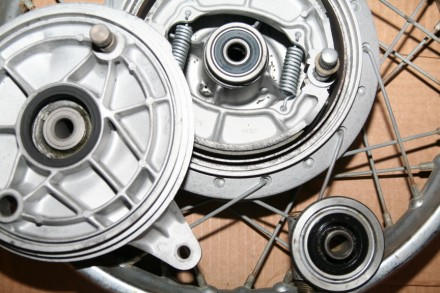

On a completely unrelated topic, I have pulled the front wheel to clean it up before my new tires arrive this week and plan to repack the bearings before putting it back together. I notice that there are 2 rubber seals, 1 on each side of the axle, for retaining the grease. They appear to be in good condition but I did have a LOT of grease accumulation on the outside of the speedo sending unit. There is also what I would call a ribbed o-ring around the outside of the speedo sending unit housing. Can these seals be replaced? The dont come out easily and I dont want to destroy them if I wont be able to find replacements.
round black rubber seals at bottom left and bottom right.
