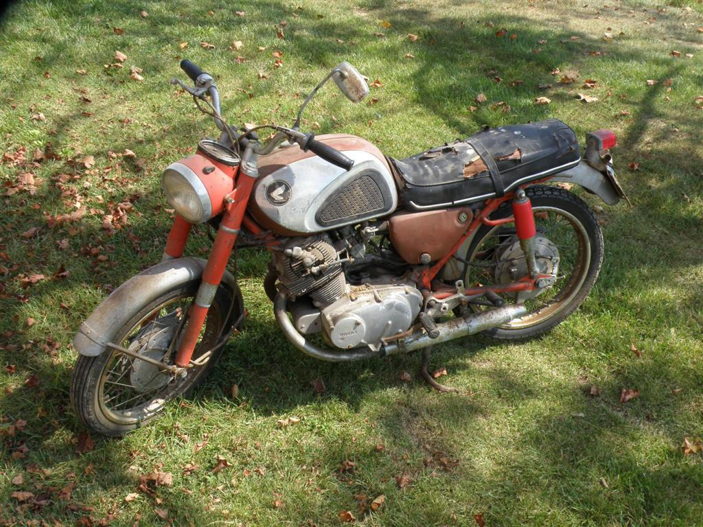

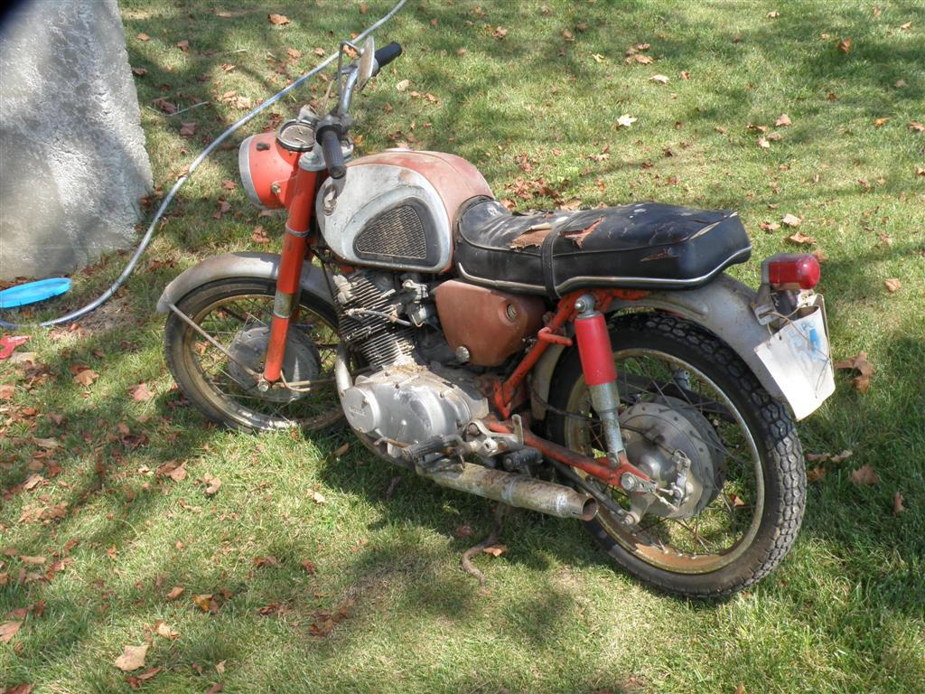

Ok, here is where I will begin my restoration trek. Maybe it will take me a year or maybe five, but it all has to start somewhere. I just purchased this '62 Super hawk on Monday and here it is Wednesday already and I have the seat, tank, carbs, etc already torn off and can't wait to get more done.
The bike was running when it was parked 17 years ago in a shed. As you can see, it has seen better days. It looks mostly complete but obviously that exhaust isn't stock. I haven't tried to turn the motor over yet, as it is missing the kick start shaft and the chain is not installed. I have looked over the site for about a week now and haven't even scratched the surface of the wealth of knowledge contained in these pages. I know that this site and it's members will be an invaluable resource. I ordered the parts manual and the Bill Silver books to get me started. So until next time, take a look at the pics and I will welcome any information, tips, tricks, hints, comments, or shortcuts that anyone would like to offer.
(Notice the 30 day tag still on the bike from when it was parked years ago)

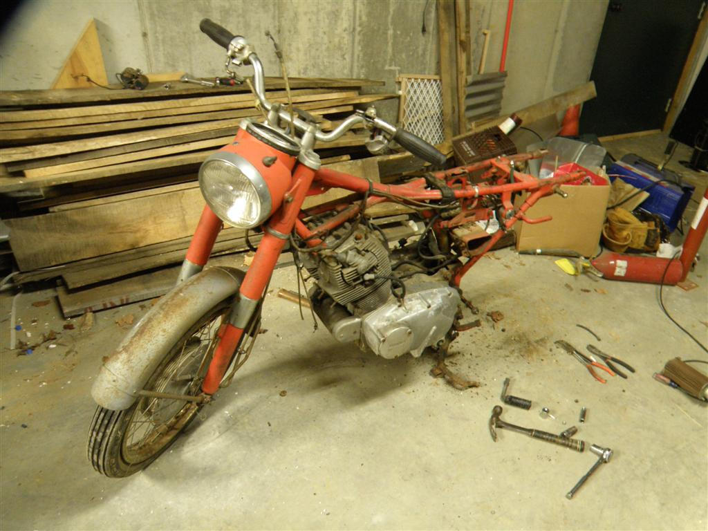

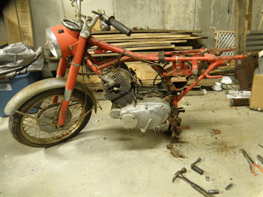

Here is the project after one good evenings work. I must say that I feel I did pretty good getting torn down this far in just a couple of hours. Having a good work area with a tool box right next to me that is well organized helped out quite a bit. That and a freakin' big ol' hammer.
Numbers on the bike are: CB77E-1015211 AND CB77-1015153
Any help with the numbers would be welcome info.
