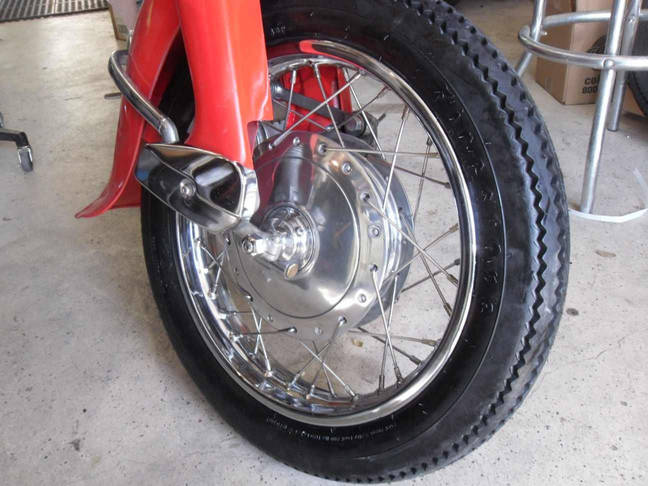

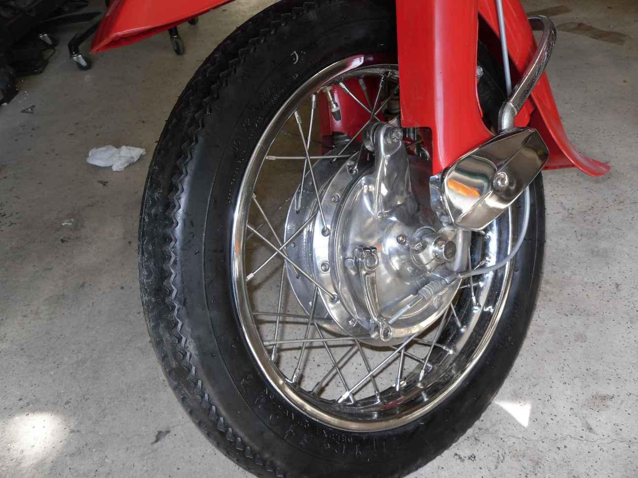

Finally got new spokes - Buchanan stainless with nipples - I polished the spokes and nipples and assembled on a new rim. Got a new Firestone tire - blackwall - only $35 for a blackwall - $145 for whitewall - deciding on the blackwall was easy.
Got all this temporarily mounted to the front end to see what it looks like. Now waiting for the seat and will start on the back wheel - new rim, spokes and tire. Kind of slow but unsure.

Who did you get the tires from?

Post by cadman » Mon Apr 15, 2013 8:57 am
Coker Tire

Post by Tango911 » Mon Apr 15, 2013 11:09 pm
well done!!
